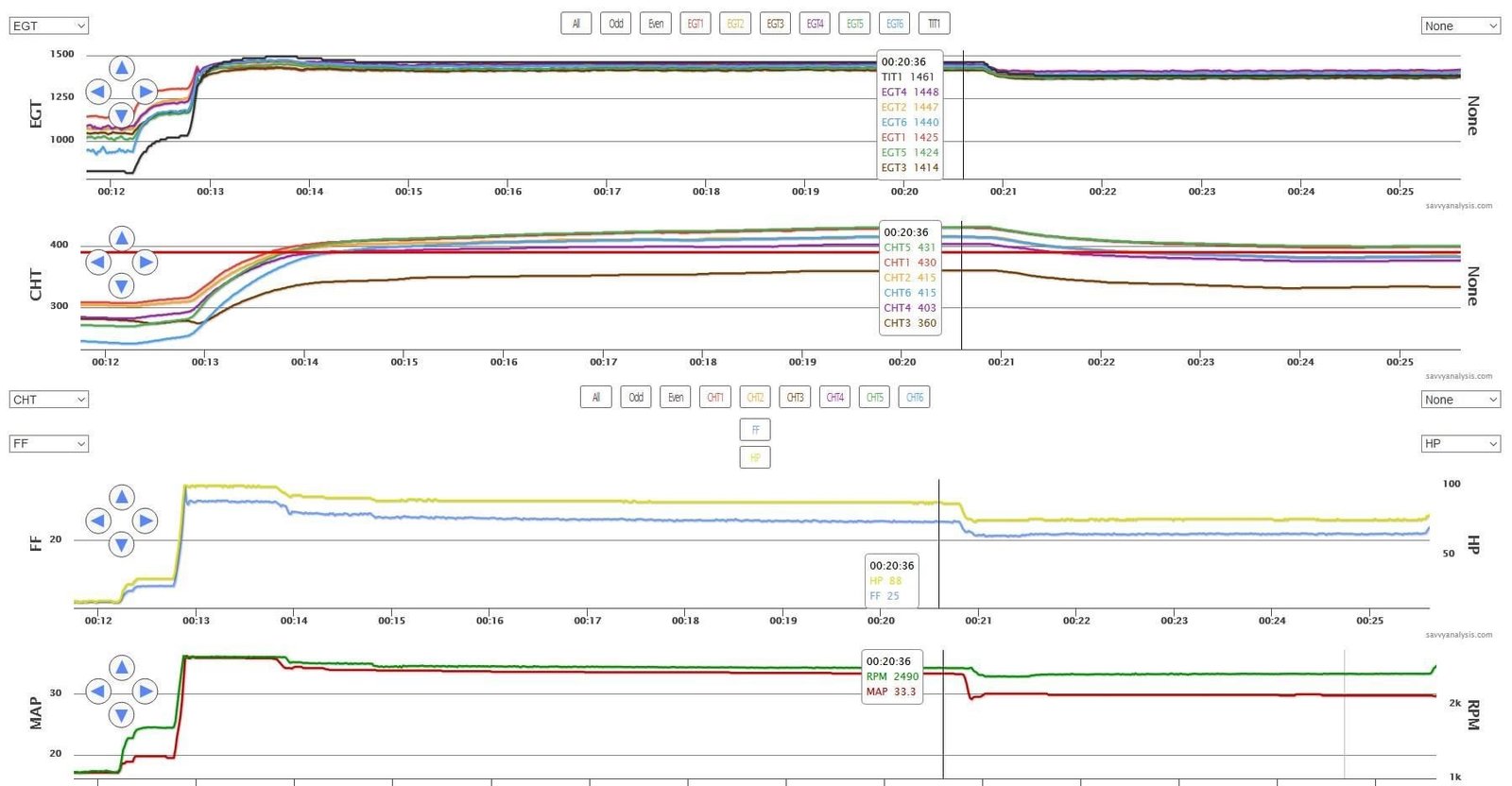

How have you solved high temperature issues? With my tsio520m on floats I just can't keep the cht's below 400 after takeoff and during climb. Today cyl#5 peaked at 437 with an oat of 85F, 32"/2500rpm, 25ff full rich, cowl flaps always fully opened, enlarged ones, 90kts climb.
Will try to climb at 100kts, tune for 0.5gph more (I'm getting 30.5 on takeoff not 31), fine tune the fuel system as per sid97-3 (now part of M-Zero I was told), check baffling again, check oil cooler and thermostat (peaked almost at redline with 237F), mag timming (21 btdc iirc).
Trying to figure how lonely I'm on these high numbers

I’d go for higher fuel flow at takeoff power. Book number is too low in my experience.
What are your ambient temps?
Re: Controlling CHT's
I was concerned I reached 437F with an oat of 85F: it will not be unusual to fly with 92F ambient, that's what summer and floats are for, aren't they?
Can you recall how much FF you got dialed for takeoff power? I'm thinking about asking my AP for 32gph
Data of flight, primarily takeoff and climb phase.

Canalguna wrote:I was concerned I reached 437F with an oat of 85F: it will not be unusual to fly with 92F ambient, that's what summer and floats are for, aren't they?
That's warm for floats, no doubt. I've worked floats in 185s and 206 at over 100 F, which takes restricted climbs, and paying careful attention to CHT and oil temps.
I liked to see at least 30 gph flow and more like 34-36 at max power on the 520, and on the 550, I wanted that needle all the way off the scale, over into the neighboring gauge.

mtv wrote:That's warm for floats, no doubt. I've worked floats in 185s and 206 at over 100 F, which takes restricted climbs, and paying careful attention to CHT and oil temps.
I'll gather courage to encourage my A/P to crank the flow to something around that. Anything to control those darn temps.

Close your cowl flaps a little, they may be too far open creating turbulence around the opening instead of a suction.
Make sure baffle material is not folded backwards, this happens when reinstalling cowling that many pilots and mechanics over look.
Make a note of what your full throttle fuel flow is on take off and initial climb, compare with what MTV suggests.

Thanks for the info Barnstormer, they do look great and glad they helped you reduce those Chts. In my case I don't know if I can add more. Just saw a P210 with a huge naca scoop on it's upper right cowling, interesting.
Kurt, your idea sounds logical, will try it, though last time I closed a notch the temps skyrocketed iirc. You're right about the rubber baffles, will check them again. I'm suspecting of wrinkles in them, like a saw on a video today. My fuel flow is 30.5 gph at takeoff now, I'm hoping that throwing buckets of fuel may control those temps, we'll see.
MTV I think you flew Tu206s on floats; am I alone in these hot issues? In your experience what would be a normal/tolerable temp in my circumstances?

Yup it seems the intercooler might help, though I don't know if it'd be worth it. I was excited about the remote oil cooler, which left the intake free for hot cyl 5, but my serial number is not contemplated in the STC. Might get a local approval for a major alteration though, things get complicated.
I can control the CHTs in cruise, it is the runaway during climb that worries me. I want to take care of the engine, and having periods of +420ºF is what I want to tackle. Hopefully extra fuel will help. Throwing 34gph instead of 31 at takeoff won't substract me considerable HP?

I already have them. It is quite frustrating that in spite of having the louvers and big cowl flaps, Chts do rise as much as they want to.
