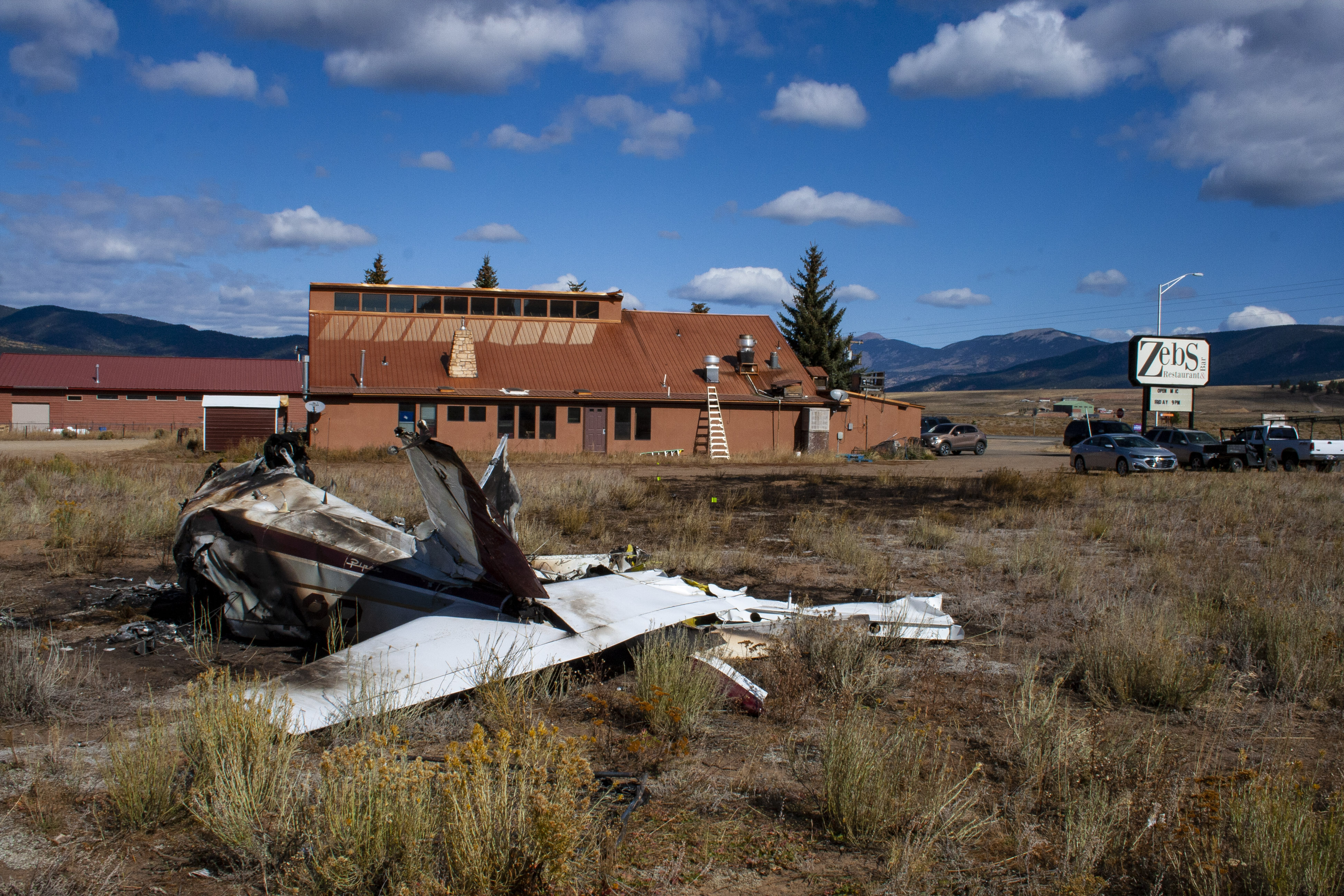

Hey there guys...I live full-time in Angel Fire and keep my Saratoga hangared at the airport here. Of course the accidents get reported, but no one ever talks much about the close-calls, which happen all the time around here. You see people clearing trees with 50 feet of clearance a mile past the departure end of runway 17. After this last crash, I decided it was time to heed the advice I have always given my son - "if you aren't part of the solution, you are part of the problem". I put together this video to hopefully help educate folks wanting to fly in-and-out of here. I know it isn't "backcountry" flying (especially with an 8900 x 100 runway), but it is definitely mountain flying.
Here is the link to the video. Your thoughts on it are appreciated. I would love to get the guys from BoldMethod or AOPA help me "professionalize" this a bit, but I know that is a long-shot.
https://youtu.be/AmrAX7tSvvQ
Photo showing crash in Angel Fire day after accident. You can see on the roof of Zeb's where the plane hit. This is approx 3450 feet from the departure end of runway 17

Good video. I wouldn't worry about how professional it is. It gets the point across, and thats what matters.
I like your point about how mountain flying with a big paved runway is still mountain flying. When we are out playing in the backcountry, we are pretty focused. Sometimes we may find ourselves a little too relaxed when we go back to big pavement runways.
Fighting those downdrafts would be hard even in a high performance plane. Relying on horsepower only gets you so far (not saying that was the cause of the crash, just a side point).
At around .6 miles to the crash, and assuming ground speed was 70 or 80 mph, things happened fast.
As a fellow Kansas pilot, he probably knew how to deal with wind. However, out here it usually doesn't go up or down, just sideways.
I suppose, like most accidents, its just a combination of factors. Downdrafts, high elevation, rising terrain, etc.

I think you are correct...like most accidents, a number of factors come together with a catastrophic result.
I have seen some local security camera footage (not public), and it is really hard to tell, but it doesn't look like they had max lift flaps in, and you could tell they were struggling. Of course, nose up attitude and failing to climb more than about 50 - 75 feet a half-mile past the end of the runway could be a number of things (or a combination)...heavy, slow, downdraft, bad configuration, etc. Was sad to see, but my only hope is that the video will help at least one person try it differently.
