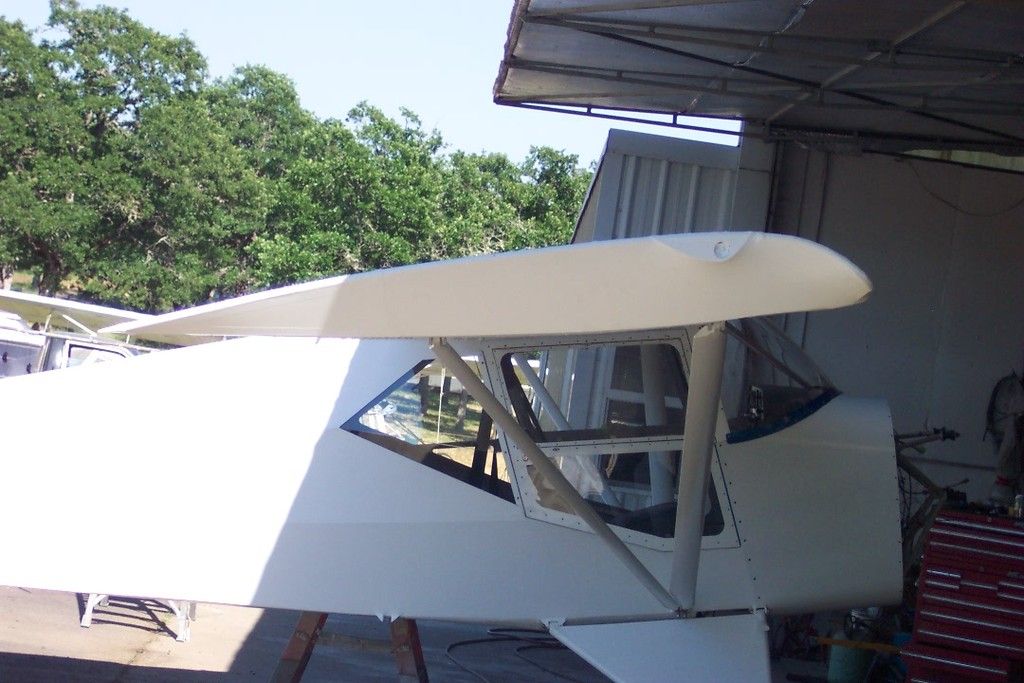

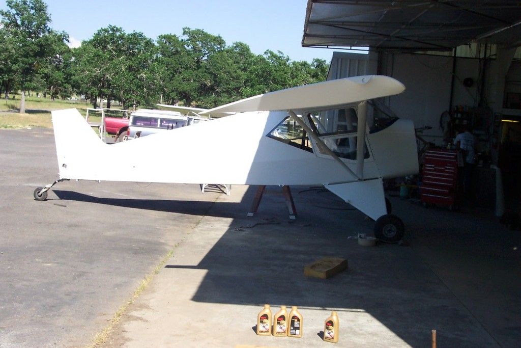

dplunkt wrote:Maybe I'll stretch a pacer, put taylorcraft wings on, add huge flaps...oh to dream!
That's been done...
Taylorcraft airfoil, Cessna flaps... 180 HP... Built locally about 4 - 5 years ago now...
Brian
Brian-StevesAircraft offline
Posts: 759
Pavement scares me..........
That's been done...
Brian
I remember seeing this a while back and actually searched for it a few weeks ago out of curiosity...
What are the details on the build and are there any more pictures?

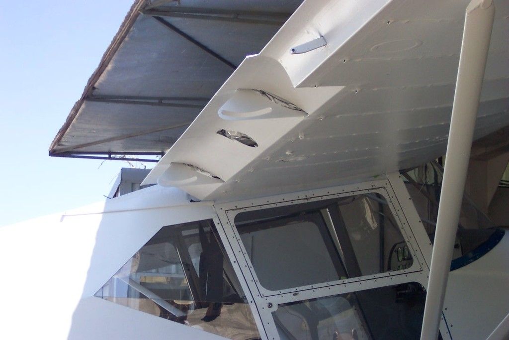

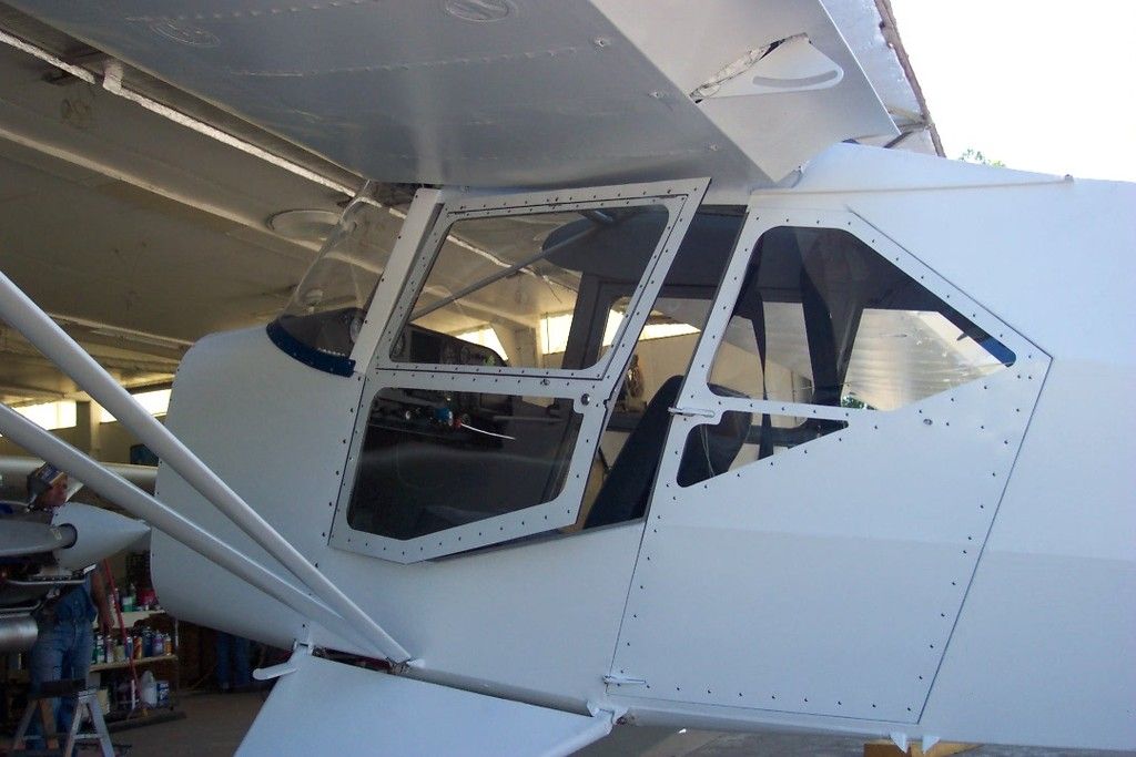

That's been done...
Brian
I have to go off my memory here.... Its been a while....
The ribs are 3 piece stamped Taylorcraft.. The leading edges were canted down slightly to give it a cuff..
Flaps and tracks are straight off of a early Cessna 172...
22 inch stretch in the tail... Firewall moved forward 6 inches... Cabin raised 3 inches...
0-360 from a helicopter converted for horizontal... Engine mount is Zero thrust line...
Maule Oleo on homebuilt gear legs...
I do not remember any of the performance specifications...
The owner has since had 2 kids and I do not see him here much anymore... Last time was over 6 months ago...
Here are a few pics when assembling the aircraft... These are all I have...
Brian.

Re: Cub wings
Wow, that looks like a potent airplane!
Did he enlarge the tail surfaces over the stock T-craft or Piper? Those big Cessna barn-doors create a pretty fair pitching moment, and on top of that he will have increased the camber some more by drooping the leading edge ribs... causing a little more pitch-down. Stretching the tail will give him some more tail volume and pitch authority... but I still hope he put bigger tails on it.
But... freakin' wow !

EZFlap wrote:Wow, that looks like a potent airplane!
Yes, I forgot about that in my other post.... The stock PA-22 tail feathers were lengthened in cord I think 4 or 5 inches...
