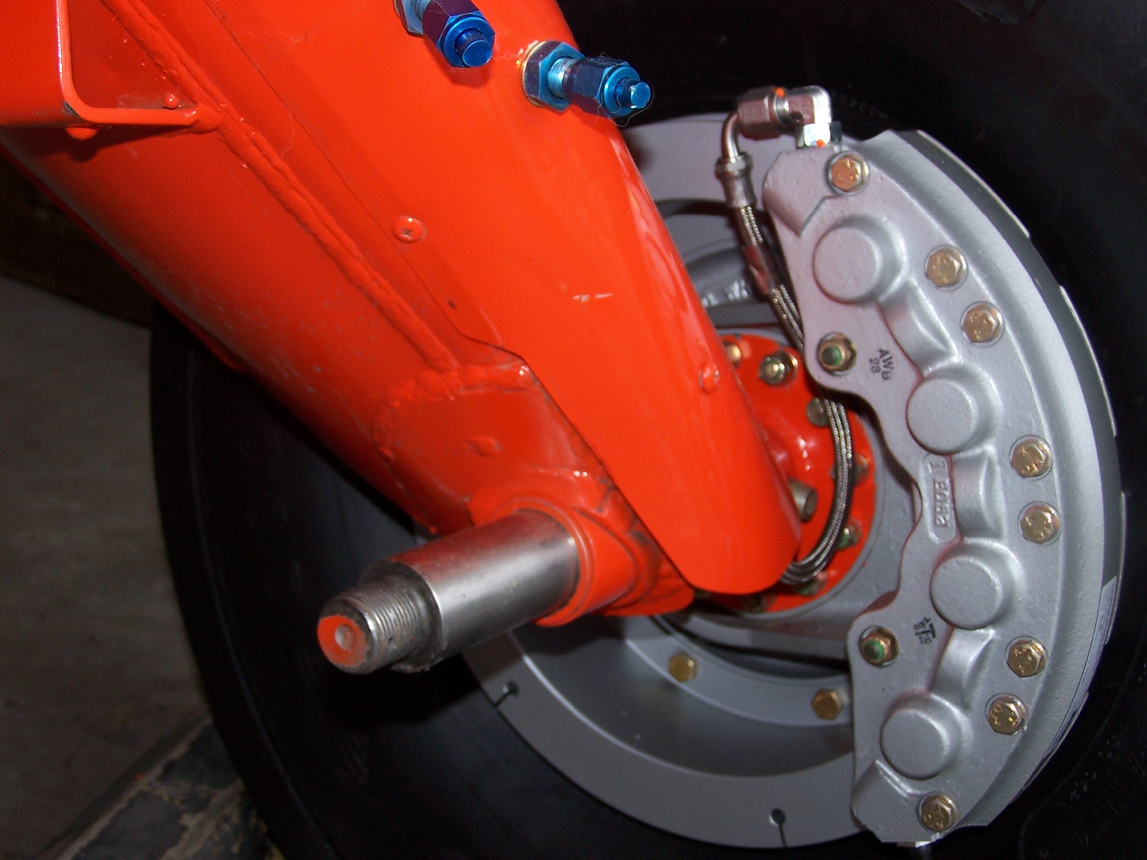

I’ve got capped off fittings coming out of the side of the fuse above the gear legs that I assume are for ski hydraulics? These photos don't show the gear legs very well, but if you look closely you can see the hydraulic fittings on the fuselage? Any idea if these legs look like ski gear legs?
highroad offline
Posts: 778
Re: DHC-2 Beaver Wheel Skis
Here is a photo of the lower end of the gear leg on our Beaver showing the stub axle to which the ski attaches, also note the lower bulkhead fittings to which the flexible hydraulic lines from the actuating cylinder on the ski attach. There is also a NAS bolt through the ski axle that is required per AD that is also shown in this photo (can just see the internal wrenching head facing forward by the brake line). The rigid lines run inside the forward gear leg fairing and terminate at 2 additional bulkhead fittings at the top of the gear leg. Your timing is uncanny as I just finished writing a short article on the installation of the hydraulic system for our skis. I have Federal AWB 4820's which are on the TCDS for the DHC-2 MK 1. I promised this to Zane some time ago, I shall email it to Zane and he can post where he deems appropriate. This article "Part One" is just the internal hydraulics required in the aircraft for the Federal AWB utilizing a double acting hydraulic cylinder on each ski actuated by a manual hand pump. Part Two, yet to be written, will include the required brackets and rigging and I shall author upon installation of the skis themselves.

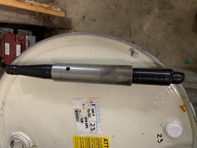

Beaver ski axle.jpg (94.08 KiB) Viewed 2315 times
Depicted is a ski axle for a Federal AWB 4820 ski on the DHC-2, I would have to refer to the Fluidyne drawing for the part number. They are Federal skis, however, the drawings for installation are Fluidyne, don't let that throw you. F. Atlee Dodge in Anchorage is now the authority on these drawings and very helpful. FWIW, this axle is a different part number than the one called out for DeHavilland skis. My skis and all associated installation parts were removed from a Beaver operating out of Churchill, so everything was included, even a cold weather "front" for the 985. I'm familiar with the "tow loops" on the stock axles as I have another set of gear that I took off our Beaver during the restoration that has the stock axles. Another set of gear became available that had the ski axles already installed so I picked them up. All I had to do was replace the AN axle retaining bolt with the required NAS bolt...and paint of course. I'll include some shots of the gear leg bulkhead fittings for the hydraulics.

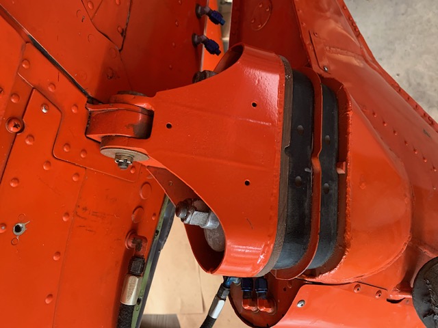

Beaver gear Hyd bulkhead fittings.jpg (102.02 KiB) Viewed 2302 times
Total of four capped bulkhead fittings in photo. Two at top of gear leg and two at side of fuselage. Two short flexible hydraulic lines (not presently installed) connect the internal aircraft hydraulic system (covered in my article) to the gear leg and down the front of the gear leg (under the forward fairing) to exit near the axle with 2 bulkhead fittings shown in an earlier posted photo. Two flexible hydraulic lines from the ski hydraulic cylinder are connected here to complete the hydraulic circuit. Note this is a different system than that utilized with DeHavilland skis.
