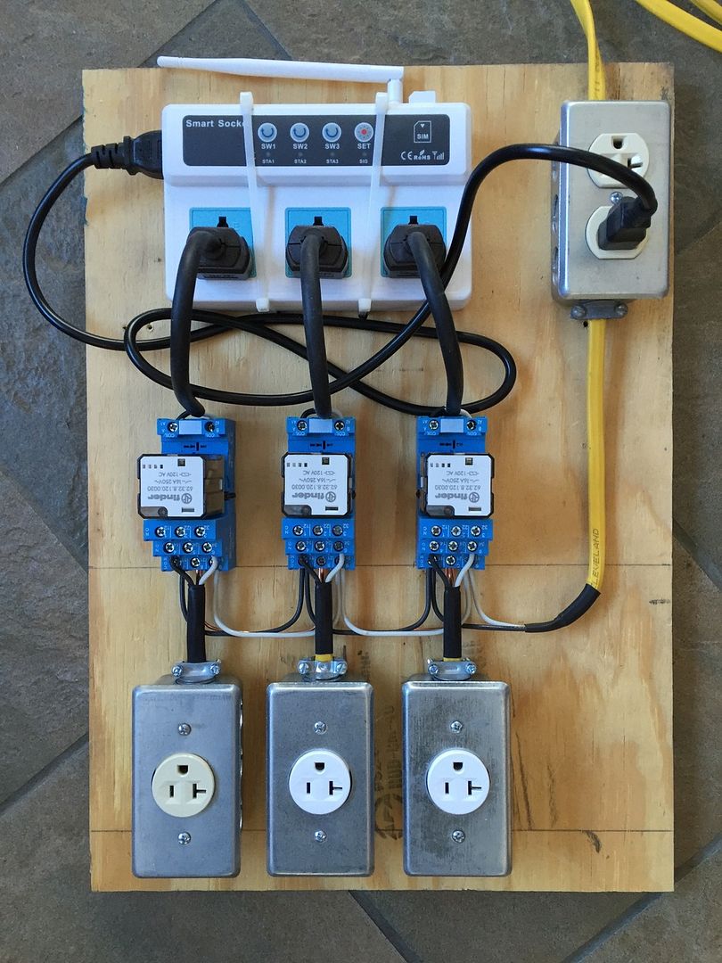

Mostly a lurker around here and not sure if this even interests anyone, but at my local field we have been talking about having something like this available for a reasonable price for a long time so I finally decided to have a go at it. Thought I would share in case anyone wants to copy!
Even though I only have a short drive to the airport, it's annoying to have to go out twice in order to plug in the pre-heater a few hours before I want to go flying. To solve my problem, I purchased a cellular switch from Amazon "Andoer Wireless Mobile Cell Phone PDA GSM Remote Control 3 Socket Power Outlet Smart Switch AC 110-220V". It cost right around $50, the t-mobile prepay SIM card was another $5 and it has a monthly minimum of $3 which includes 30 texts (.10 cents/text). The unit claims it's rated for 2200 watts, but I quickly found out that a 1500watt space heater blows the internal fuse in about a second, so it was time to get creative.
I purchased 3 16amp@220v relays which should handle just about anything I could throw at it and the accompanying sockets. I also picked up some junction boxes, outlets, AC plug ends and a 20 amp breaker.
I installed the components on a sheet of 3/4in plywood, and hard wired the power directly to my breaker box via the 20amp breaker, here is the finished result:
As you can see the Romex in the upper right is what gets wired into the breaker box, (you could put an AC plug onto the end of this if you wanted and just plug it into any 110 outlet if you desired) it feeds the first junction box/outlet which is always hot, and designed to power the actual cellular switch box. From there hot power is fed into each of the three relays. The cellular switch box now only controls the coils of the relays, which can handle much much more power than the wimpy cellular switch box itself can. Each of the relays then power the respective socket below.
It works like a dream and now I can turn my airplane heater on from anywhere, just by texting the switch box. What's really nice about this particular switch box is I get a text message response back telling me which switches are in what position. So I know for a fact whatever it's powering is actually on/off. I know these switch boxes aren't really a new thing but I have yet to find one that can handle enough current to actually run a 1500watt heater for a reasonable cost. This whole project cost me about $100 and a few hours time, it's extremely simple to build and wire up.

Re: DIY(ish) cellular switch
I see most of the questions were already answered by Rob.
This particular cellular switch is GSM, no landline required, just cellular service for the particular network you are using it with. In my case I use a pre-pay SIM card from T-Mobile. It cost me $5, there was a $10 activation fee but the minimum monthly requirement is only $3 after that. It works through SMS text messaging, which thought t-mobile is $0.10 per text. With the $3/mo it covers 30 text messages, use it more just load up a few more bucks a month. I think it's pretty reasonable, $0.10 vs driving my ass to the airport just to plug it in and home again for a few hours while it warms up. The device recognizes your phone number which you have to initially set as a accepted number in order for it to listen to your commands, so an accidental random call/text will have no effect on it. You just text the device a message, basically with what you want it to do with each of the three outlets. N=on F=off and X=ignore. So if I want all three switches on I text it NNN, once the deed is done it responds with a text message telling me "Switch 1-ON, Switch 2-ON, Switch 3-ON" so you know it actually worked.
I picked up the relays and relay sockets at a local electronics shop, they are branded as "Finder" and are 16amps at 250volts, which is something like 4,000watts per outlet. A little overkill but a nice safety margin as well.
Thanks for the compliments, it really is simple though. The relays are just switches operated electronically, and are wired no different than a standard switch, so little knowledge or skill is required....trust me on that.
I've seen cellular switches for sale ranging anywhere from $50-$500, but even some of the more expensive units really aren't designed with a high power load in mind, with this setup I can run some high wattage stuff and don't have to worry the hangar/plane will be burnt to the ground when I eventually do show up.

Newbizor wrote:...These particular relays are rated for 16 amps at 250vac, which is over 30amps at 110/120vac, well over what I plan on putting through them. I'm actually only going to wire this whole board to a 20amp breaker since I used 12ga wire.
Very nice and thanks for sharing. For safety and educational sake, I feel compelled to correct a slight misunderstanding. The relay will still only be rated 16 amperes at 110/120vac. For what it's worth, you are pushing that relay pretty hard with a 1500w heater (12.5 amperes at 120vac), for longer life and less chance of fire, go with 25 to 30 ampere rated relays.
