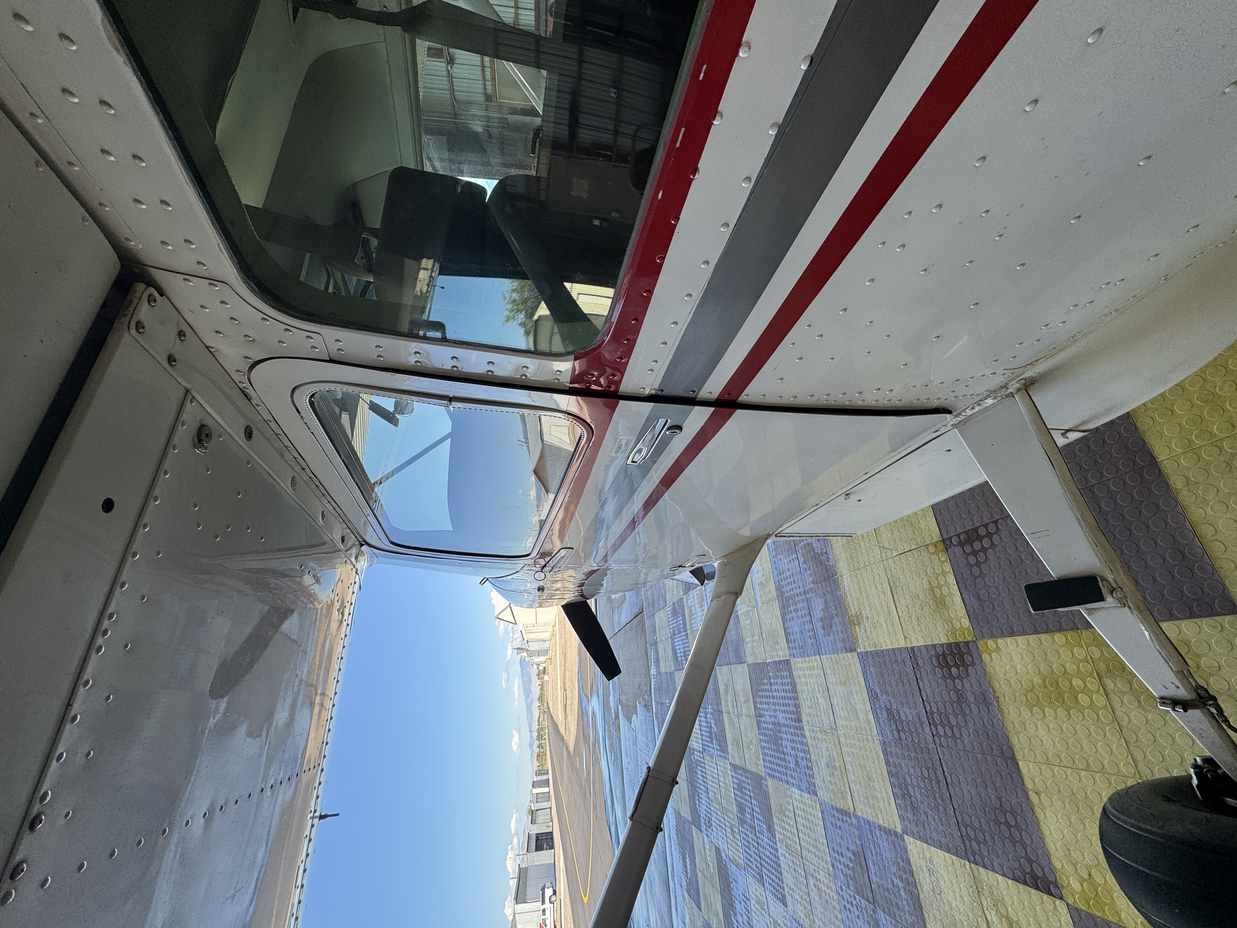

Hey guys,
Looking for some advice on the best method to correct some deflection in my door. The top of my door is tight, but rest of the back edge deflects outward just enough that the seal doesn't make contact with the frame and creates wind noise, especially at the bottom corner. Seems like the majority of the problem could be resolved by adjusting the latch, but I can't figure out how to accomplish that. Before I go start exploratory surgery on the latch mechanism I was hoping for a pragmatic sanity check from someone who has solved this very issue.

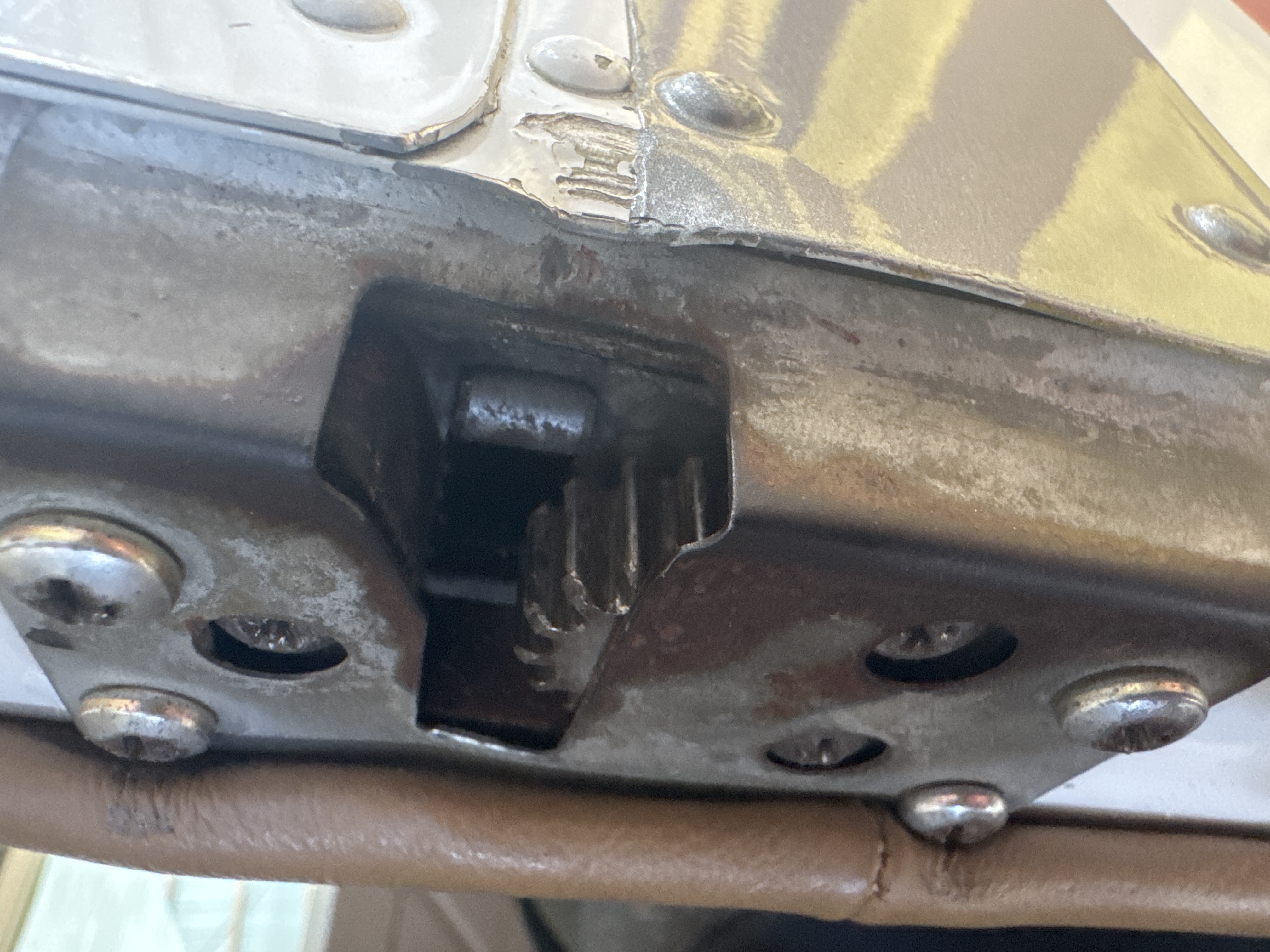

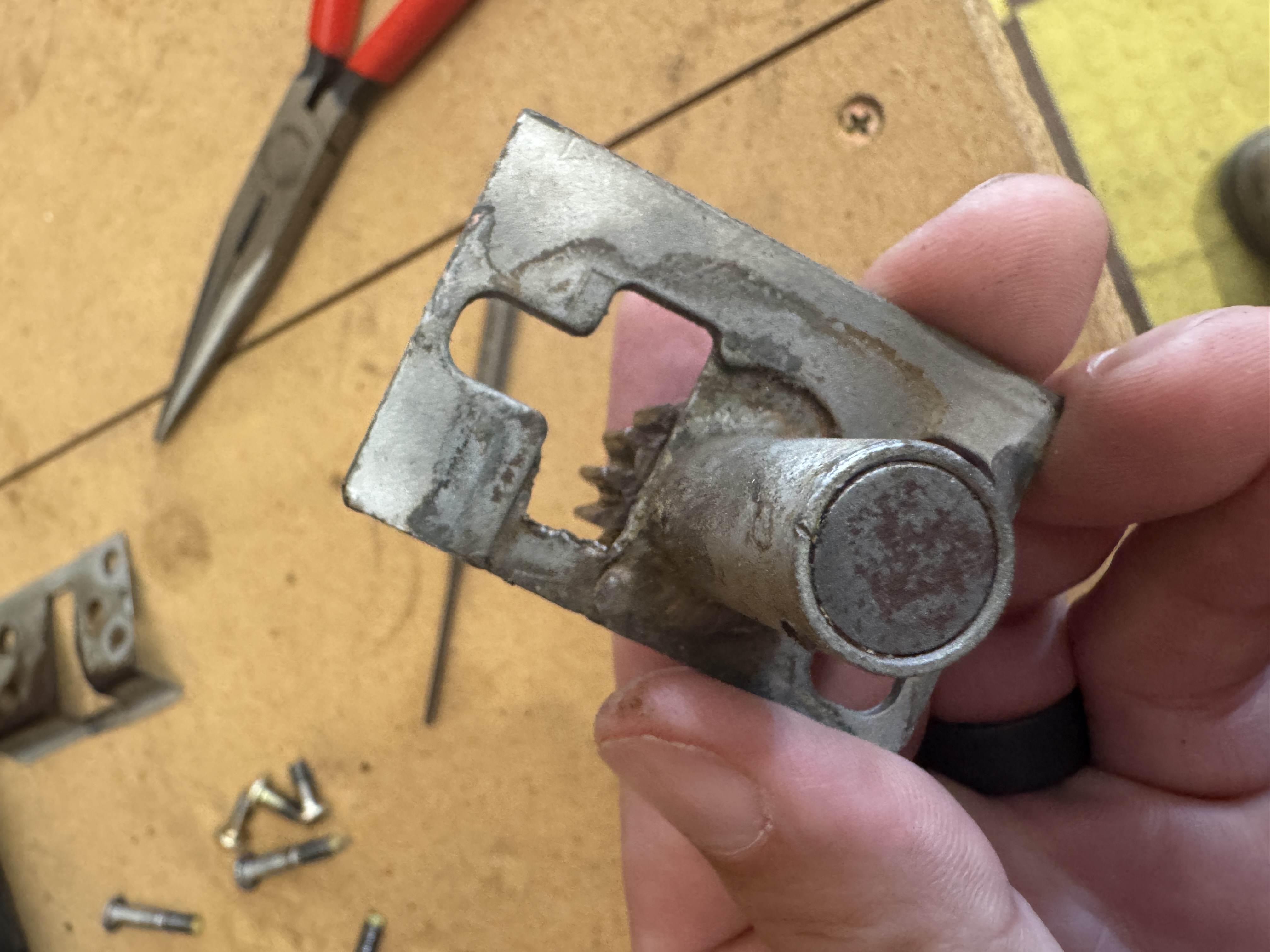

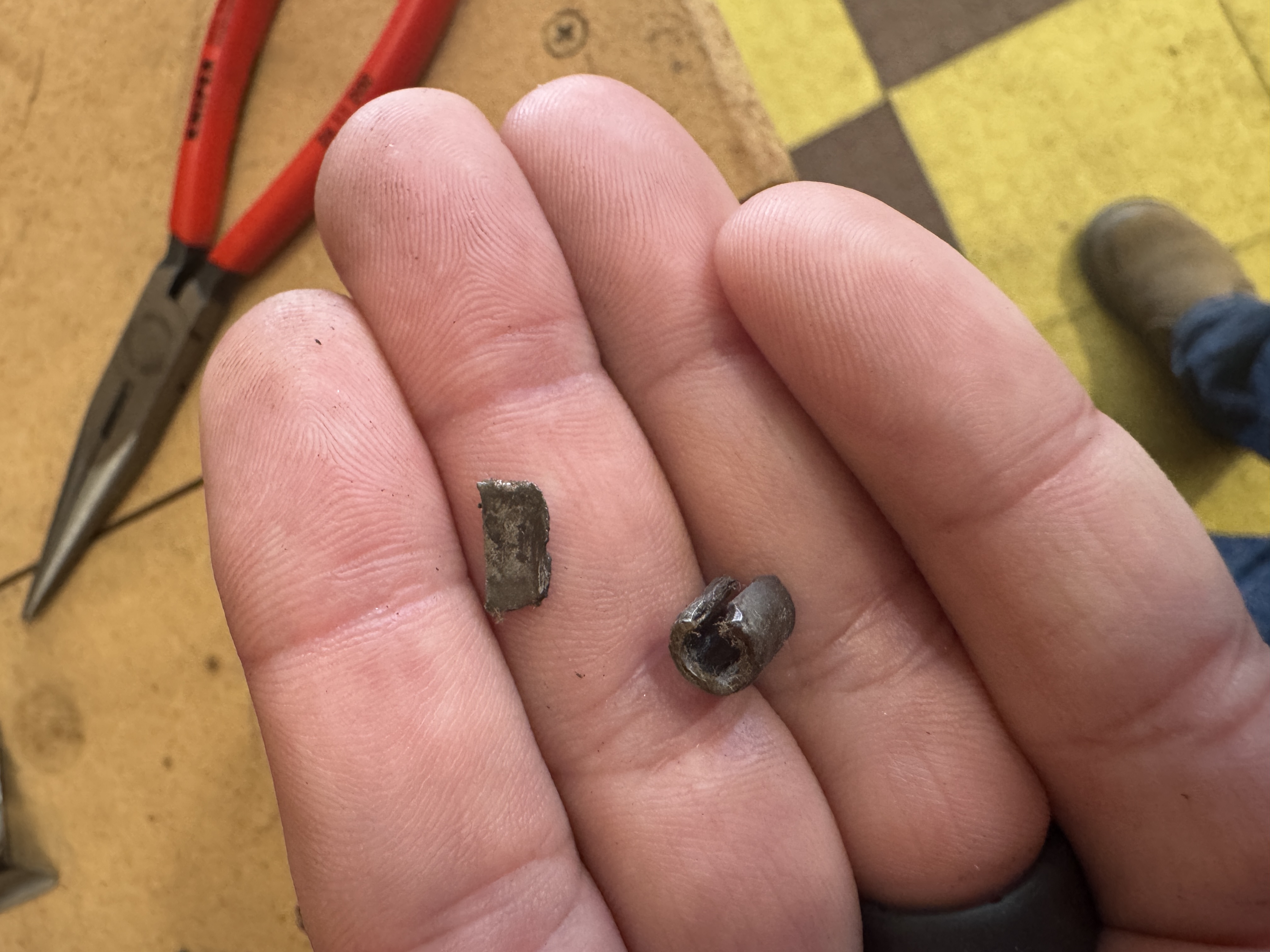

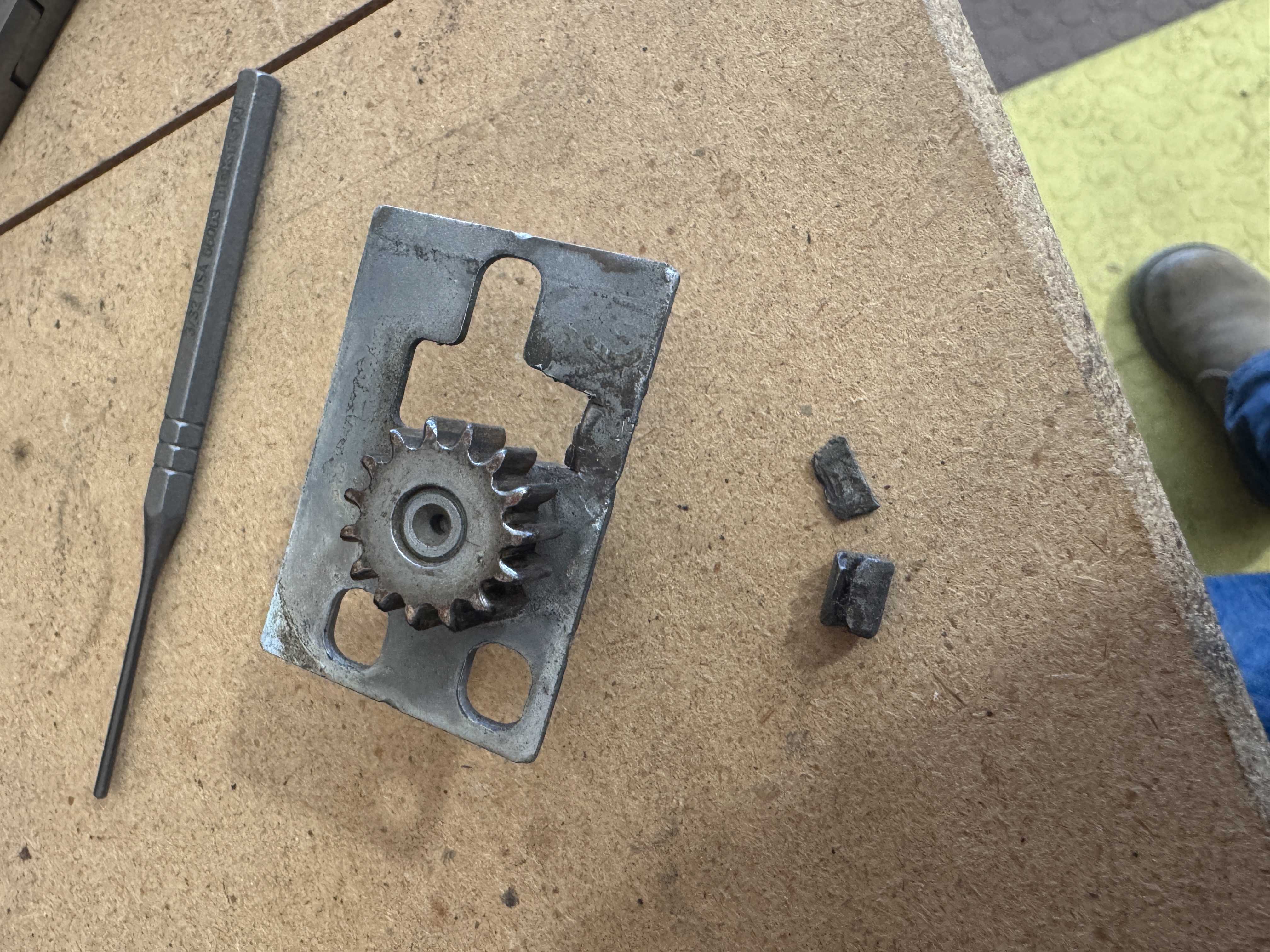

I figured it out, the little tab that holds the bushing in place in the rotary cam assembly was bent backwards and when I removed it, it just broke right off. Because it was bent back, the door was not sucking up as tight as it should when you push the door latch lever forward. Seems like what would be a pretty common failure point so I’m photos of it for anyone else that has the same issue.
The last photo shows it reassembled with the bushing snapped onto the remaining bit of tab. Even that makes the door closed tighter than it used to. I’ll leave it like that until I can find a suitable replacement.
