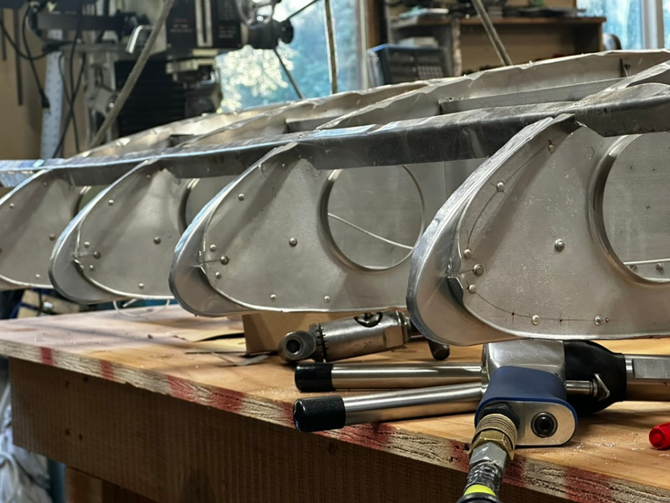

I am recovering my experimental cub wings. Ive added a cuff which I copied off the Sportsman I put on my 170. My theory is that by lowering the leading edge these cuffs slightly increase the critical angle of attack. I have also bought VGs, but actually feel that they would have worked better on the old leading edge. What I think is that you can only increase the critical angle so far, either with leading edge profile or with VGs. Ill fly it without the VGs first.
