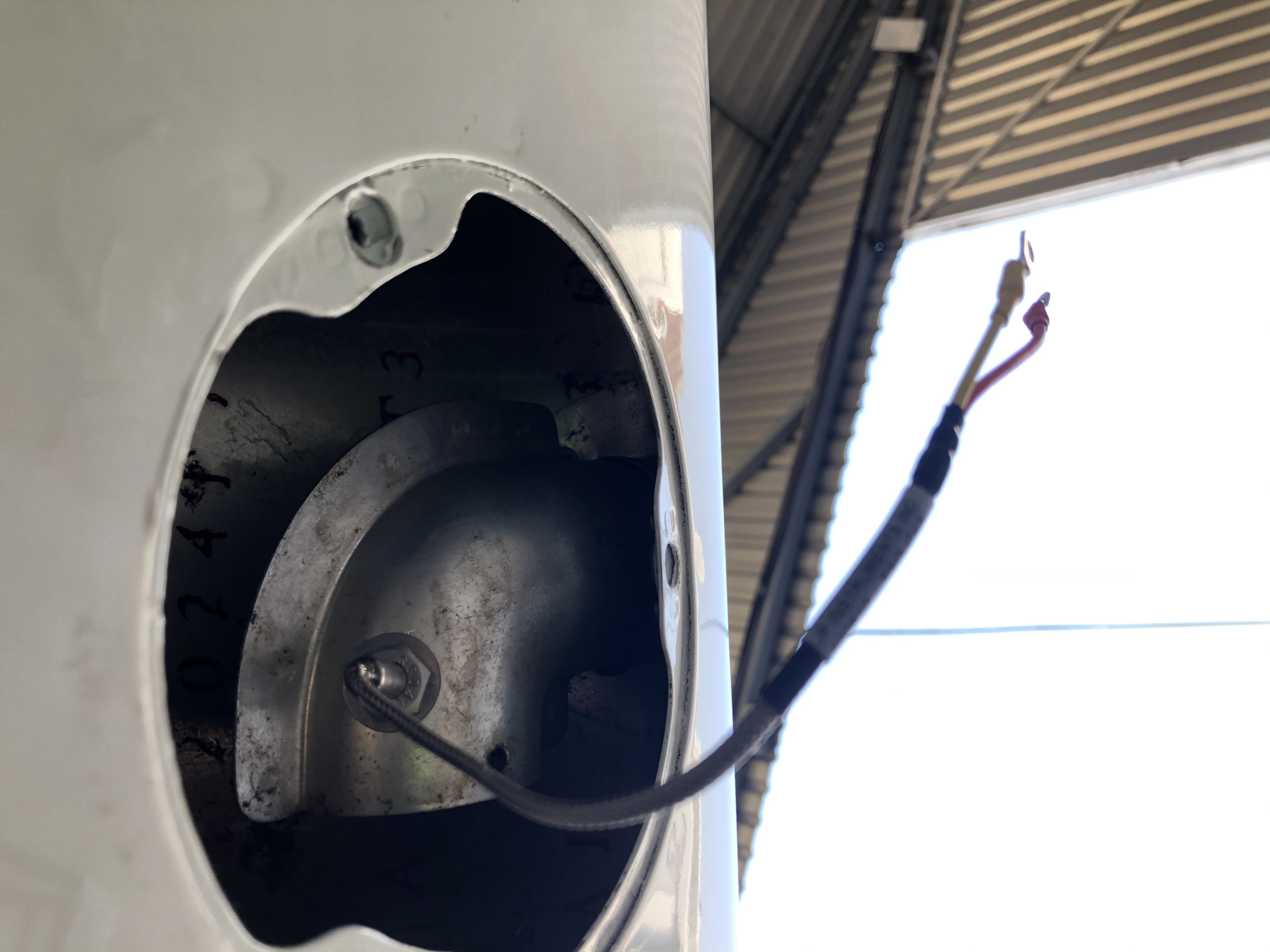

Re: EDM 900 OAT SENSOR POSITION
Right wing.
Cabin air inlet duct.
Temp sensor instalation.
Putting OAT sensors inside air inlets worked very well.
Less danger of damage when cleaning the aircraft and no holes to the outside of the airframe.
On the ground as expected, they read higher but once you have airflow all OK.
If one wants a fairly aqurate density altitude readout on the ground one should consider not putting the sensor in the duct and find a shady place outside.
One of my sensors had already been installed under the wing, say a little behind and to the side of the aft part of the pitot tube.
Still reads higher to some extend until airborne.
Think I have more OAT sensors on the 180 than on the Airbus now.
