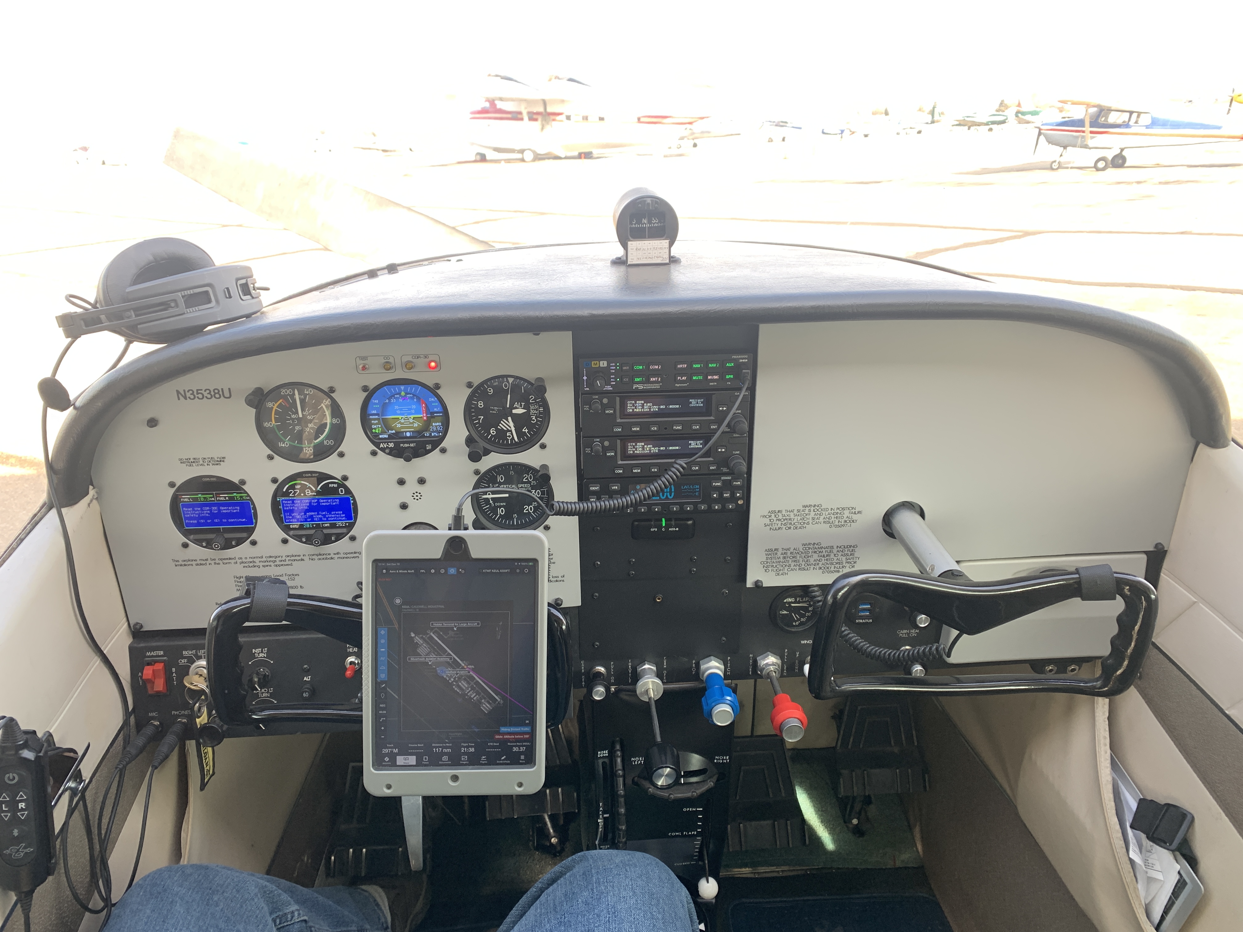

Hey guys, I have a brand spankin' new CGR engine monitor package in my 182. I've got a few hours of flying behind it, and so far I'm quite happy with the investment. One thing I'm trying to get used to is analyzing all the temperature information coming at me now. Prior to this I had a single point EGT with a simplified gauge that had no markings on it. Performance Air in Caldwell did the work, can't say enough good things about Shaun and the team there.

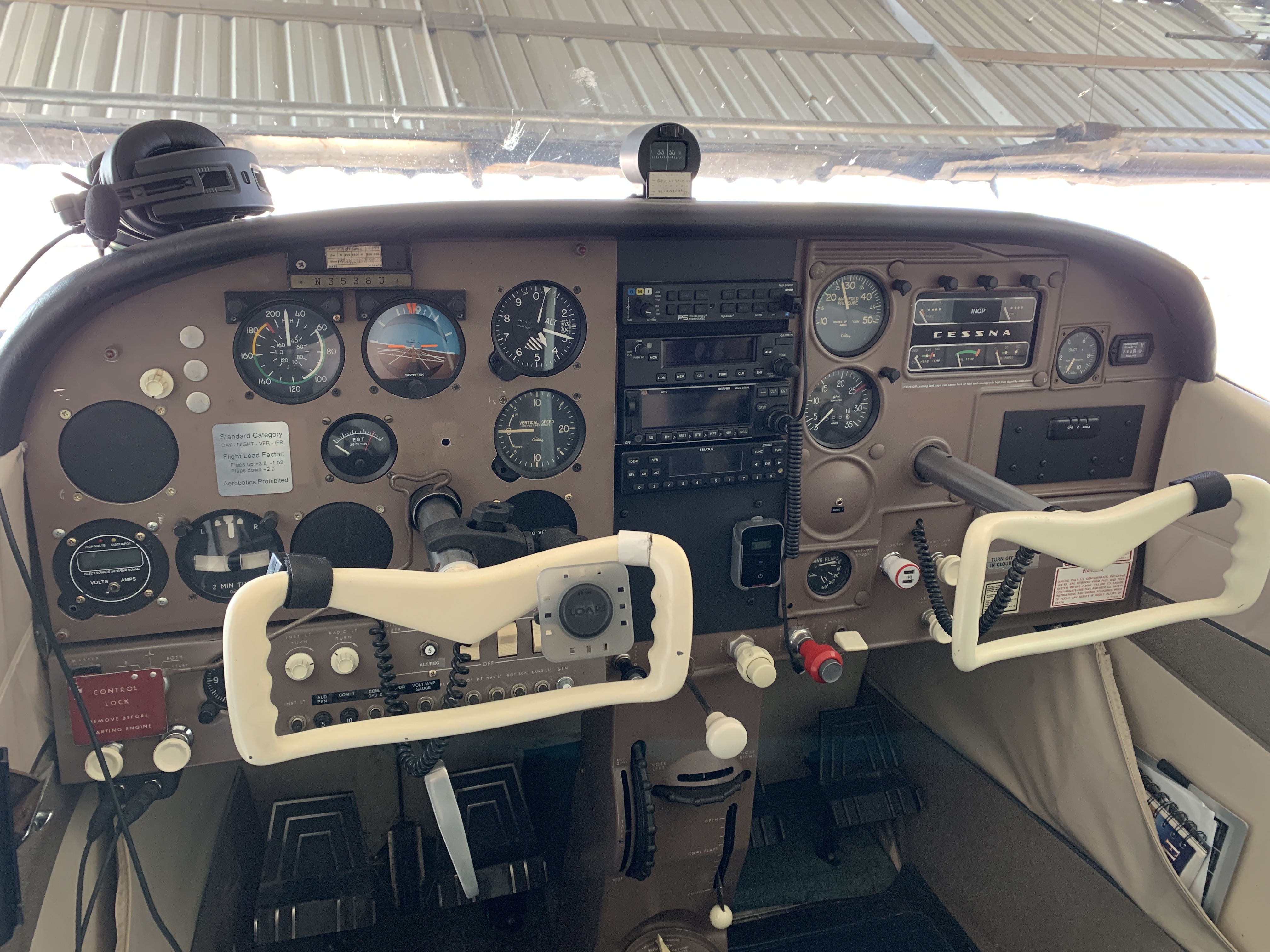

Wow, I thought the original panel in the first photo was very very nice. The new panel is even better! Very well done! Sorry I dont have an answer for your question, I just had tell you how much I like your panel and set up.
