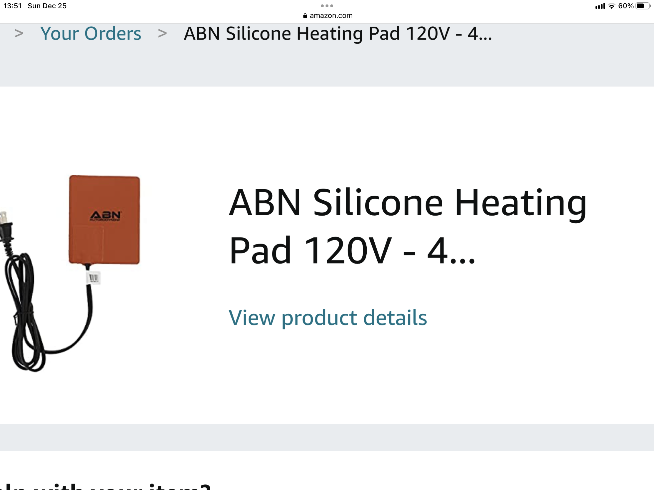

I know this is a very covered topic but I was looking for input on the validity of these small, stuck to your oil pan, engine block heaters. I was given one the other day and to see if it worked before removing my cowl I plugged it in. This device within 1min was way to hot to hold in one’s hand. Is this normal? Do you guys who fly regular real cold ops. recommend them? I’m not nearly in the climate your in but thanks to global warming it’s been in the teens here in NC. :shock:
BTY it’s not this pad but one that’s very similar

When adhered to 300lbs of metal with appropriate adhesive, the heat goes into the metal quickly so they don’t get as hot to the touch as you experienced. They work. Not as good as the kits with bands on the cylinders, but they do work. The real aviation ones (Tanis, Reiff) have temperature controllers built in. Industrial ones may not have that feature and simply be a resistance wire embedded in silicone.

That makes sense, it actually has a sticky side that you peel and stick on the oil pan

If you’re thinking of using a silicone pad attached to your oil pan, get one of these: https://www.e-zheat.com/ The plain silicone pads, as the OP noted, get really hot. They have been documented to burn oil at the site of the pad.
The E Z Heat pad is thermostatically controlled to prevent that, and much safer.

First off don't plug the thing in until it's installed. I think you will F up the adhesive (It will start to cure?). I just installed the E-Z Heat on my Champ last week (A-65). Installation was straight forward (Although after installing it, I would have a few tips for anyone doing it for the first time). I have only used it once, but it seemed to work great and didn't fall of while flying, which is good. Plugged it in overnight and the next morning the oil pan and bottom case were warm to the touch. It was +6 outside, probably teens in the hanger. I still had the cowling off so the engine compartment wasn't warm. Put the cowl back on and then put the skis on the plane. Probably took a hour and a half total. By the time I unplugged it the engine compartment was warm as were the cylinders. It does get hot to the touch though, although as MTV said they are supposed to have a thermostat to prevent overheating. Not sure how they work on bigger engines (There are multiple sizes), but it seems to work well on my little one.

I've used E-Z heat on my last two Franklin engines and I agree, the thermostat works great. Nothing on the engine (mags, cylinders, starter) is ever too hot, more like warm on a summer day. On my Franklin, the cams are low in the engine and don't collect moisture up high like a Lycoming, so I feel comfortable leaving it plugged in for periods of time. My electrical draw is about 300 W on start up and about 175 W when warmed up.
