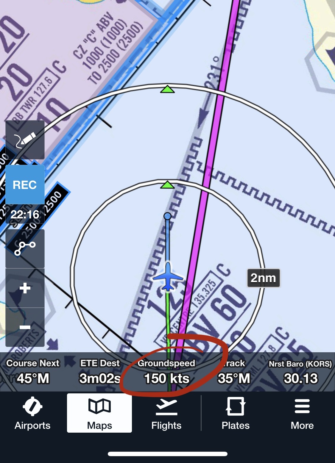

PIREP on conversion from Mac c403 on a185f with IO-520D, a prop you do not hear much about on here to a Hartzell Voyager and no other comparisons that I have seen on here. If you are offended and triggered by fast skywagons click back or call your mother. Speed matters. I only operate on nice turf and asphalt for now.
The bad:
Weight: at 77lbs added about 9 pounds on the nose
Speed: Lost 3 kt at at 7500 WOT 2400 RPM from 153kt to 150kt TAS
The good:
Great customer experience. They gave me a nice OSH discount. Answered all my annoying questions patiently.
Installation kit and instructions were thoughtful and complete
The great:
Looks even better in person
The butt accelerometer demonstrated faster acceleration from a stop
The noise on takeoff is spectacular
Overall, I am thrilled with it and believe it was good value on new hardware that takes an operational beating. I do not see it changing how I operate meaningfully but it I do not have floats, operate at or near gross weight, or very high DA.

Did you do measure your speed at the same CG? My experience has been that speeds can easily vary 3kts or more simply sliding the cg around. With your fwd gain, you may have the same exact speed (all things equal), or potentially gain a kt or two by putting the cg back where it was when you had the 403 on.
Take care, Rob

Rob wrote:Gorgeous airplane.
Take care, Rob
Thanks. N1015F is enjoying its semi-retired life in the pasture as a family hauler on nice grass strips. Your point is well taken. There are so many potential confounders that prevent an amateur from doing a controlled test. The plane was probably 50 pounds heavier and CG similar, but higher DA with the second run with the new prop. The only firm conclusion I can make is that the old C403 was actually good on performance contrary to the many expert opinions that I sought that indicated that it was a garbage obsolete prop. I do not believe a heavy prop is a bad thing as it serves as a flywheel integral to direct drive engine operation.
