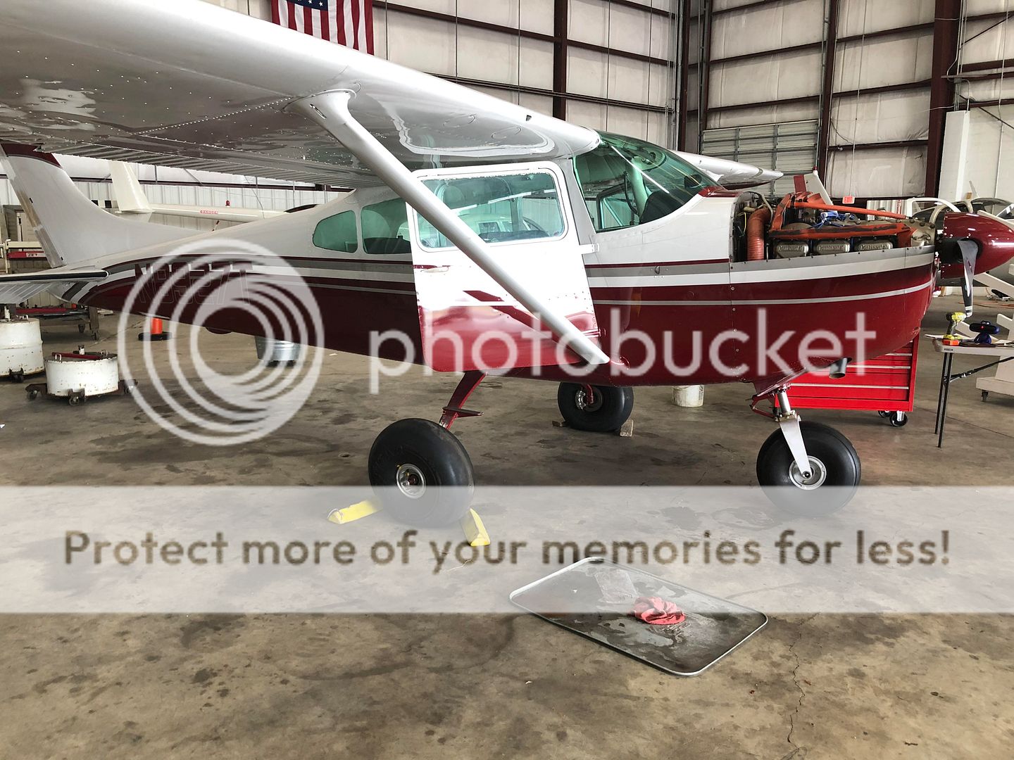

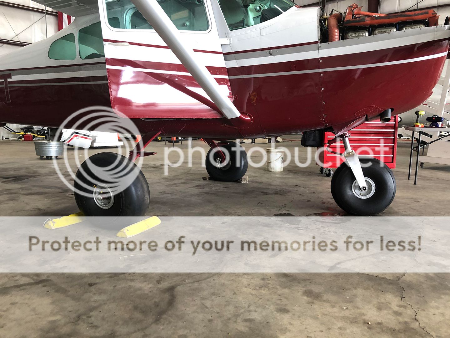

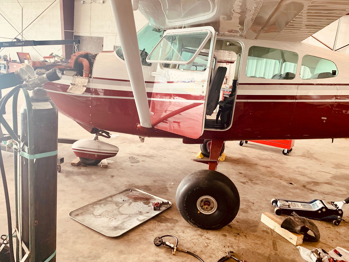

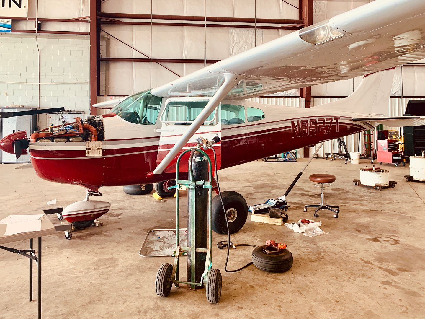

All done. Not sure exactly what all my mechanic had to do for the 337 but he didn't make it seem like it was any big deal. The whole process took about 2 weeks from the time I delivered him the STCs and the prior 337 shown above.
The only thing I've noticed which I want to change is to switch out the axle nuts used for the wheel pants to regular castle nuts. There's just something my OCD brain doesn't like about it otherwise.

Looks great. If you have hollow axles I would not use regular castle nuts. The wheel pant ones keep dirt, water, and other crud out of the axles...

A1Skinner wrote:Looks great. If you have hollow axles I would not use regular castle nuts. The wheel pant ones keep dirt, water, and other crud out of the axles...
Roger that. Thanks!

Free sticker to you for posting photos of the outcome. PM me your address.
Posts: 3008
Re: Field Approval for 26s on a C182
One cool looking bird. Love the colors and the wheels and tires make it.
