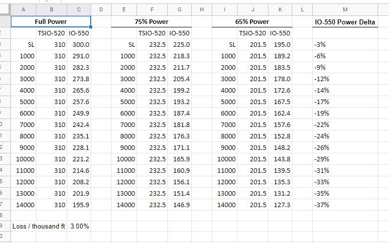

I'm not sure what the critical altitude is for the TSIO-520, but assuming it's over 14k feet this is what the deltas look like assuming a 3% loss per thousand feet for a normally aspirated engine.
Now, I realize reality and spreadsheets don't match all that closely, and I also recognize that real world experience trumps this but I wanted to share this in case anyone was curious.

Re: Finding that next plane?
CParker wrote:I'm not sure what the critical altitude is for the TSIO-520, but assuming it's over 14k feet this is what the deltas look like assuming a 3% loss per thousand feet for a normally aspirated engine.
But, that assumes that TSIO 520 actually MAKES rated power. Under the certification that engine was certificated under, it could legally, brand new make 5% less than “rated power”. That standard called for + or - 5% of rated power.
The Certification standard the IO-550 was certificated under requires those engines to produce no less than rated power. That standard is + 5%, - 0% of rated power.
Low Rider, the only 350 hp rated engine in a 206 is the Turbo Tech conversion, which uses a Lycoming TIO-540 engine. That is a VERY expensive conversion and I’m not sure it’s still available.
But the TU-206H model airplanes use a Lycoming engine, but not the 350 hp version.
I think if I really felt like I needed turbo in a 206 I’d take a hard look at the H model. Has the advantages of the G, but, frankly, a much better engine. The H does tend to be heavy, though.

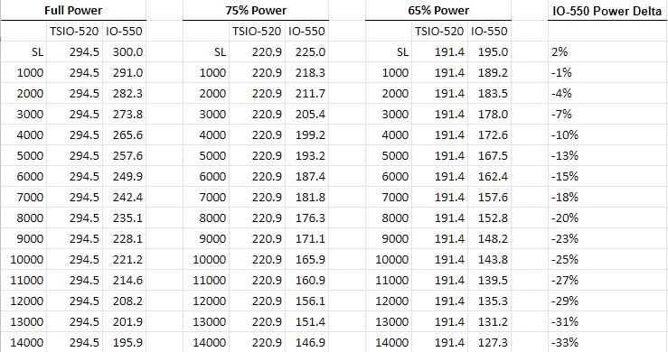

I appreciate the discussion, and to be clear I did not share that spreadsheet in an attempt to defend the turbo engine I was just sharing my analysis. Frankly, if the IO550 is indeed the better fit for my mission profile I will change my tune.
MTV - interesting you say that because I've heard quite the opposite about the turbo Lycoming in the H model. I've heard it runs rougher, burns more fuel, and is quite a bit more expensive to maintain. I have zero personal experience with them.
EDIT: updated spreadsheet to account for 5% penalty on TSIO-520, and again there are many variables here and this is simply a math exercise.
