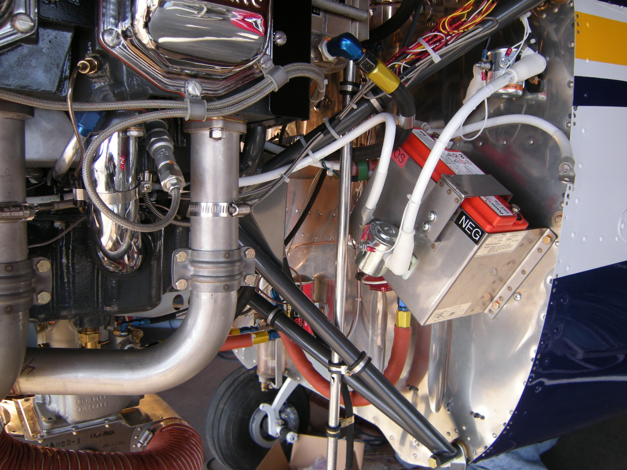

If possible, place the battery box in such a way you can replace the battery w/o requiring removal of the entire cowling....and be sure it is placed such that you can get the battery in the box (yup I made that mistake first time!). I also used Bogart cables and a new ground strap from engine to frame.

john54724 wrote:If possible, place the battery box in such a way you can replace the battery w/o requiring removal of the entire cowling....and be sure it is placed such that you can get the battery in the box (yup I made that mistake first time!). I also used Bogart cables and a new ground strap from engine to frame.
Thanks. Nice install you did.
Incredible 170 John! Love it!
