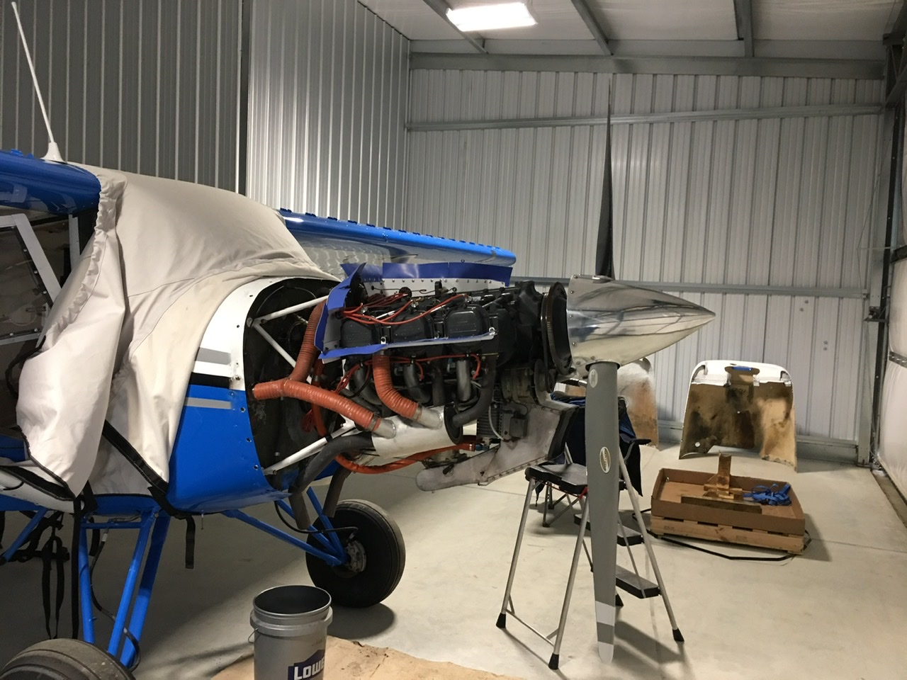

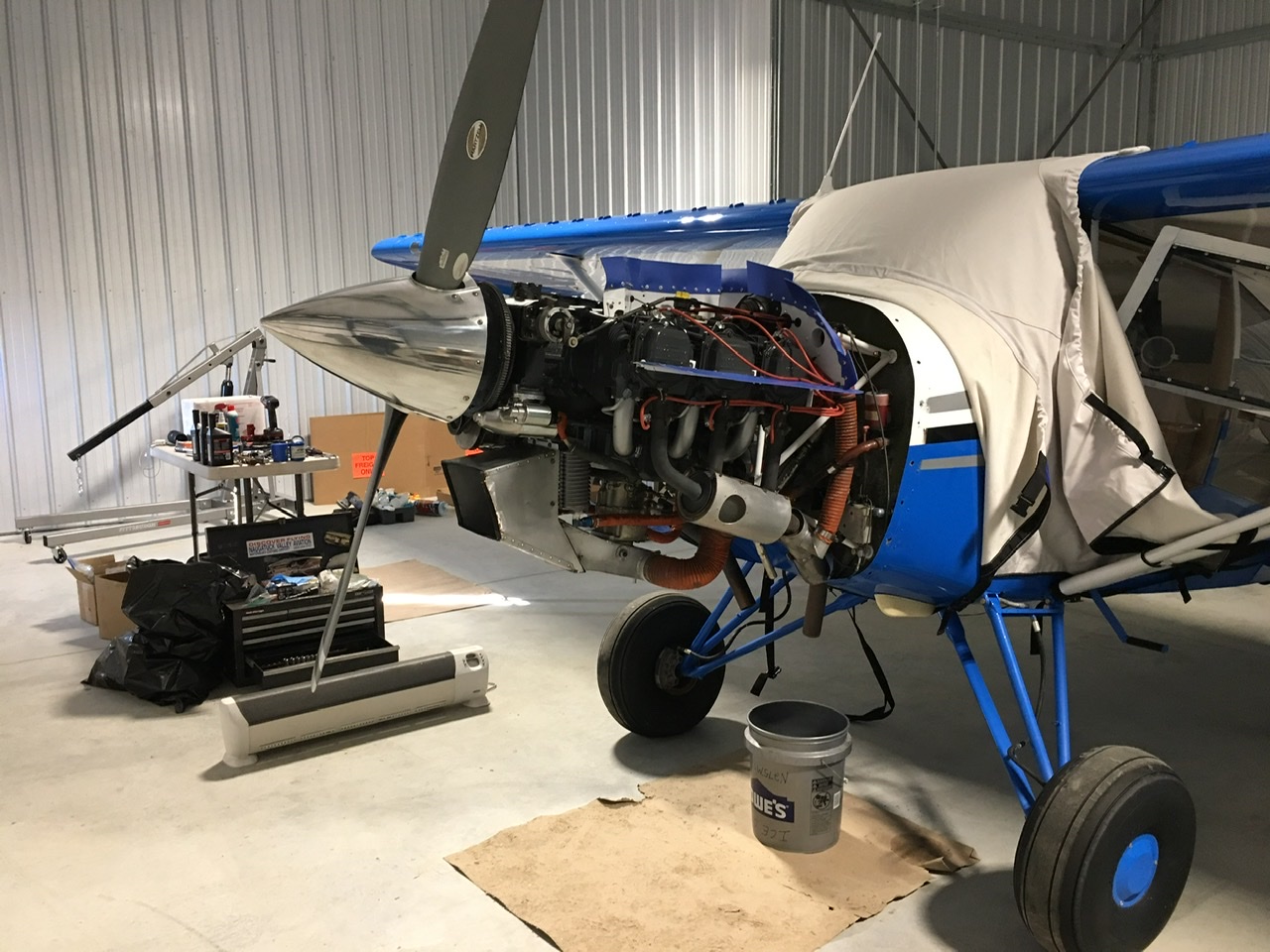

Do you have the Aux heat/ heat cuffs on both exhausts? I can melt peanut butter on the floor in mine with temps below zero. We did exactly that on the way home from Alaska. Now the drafts up top are cold but the heat cranks. Seal up the drafts. It's worth it.

You have an M5? I have an M7. I've gotten a couple reports about the 5 having plenty of heat. But I'm still chasing a solution in the 7. I have the drafts somewhat under control with closed cell foam, and the floor vent puts out decent heat, but otherwise not much.

Yes mine is an M-5. Do you have a heat outlet between the left set of rudder pedals and/or one under the right seat? The one on the pilot's feet definitely makes a huge difference. Keep the feet warm and all feels great. I was trying to check your heat controls in your videos but never saw a close up anywhere.

Had the same exact issue with a customer of mine. His 5 had great heat, went to the 7 and it was terrible. Even with the aux heater. He sold it.
Re: Flew up to visit Zane
Very interesting. Have any pictures of the baffling, heat muffs, scat tubing, slide valves etc for the 7? I wonder what changed. Any idea if it's an airflow issue or just blowing cold air not enough heat transfer in the muffs?

Right muff heat comes from outside of right cylinder baffle through the muff and valve then goes to defrosters and under right front seat floor outlet. This one melted Peanut butter on the floor
Left tailpipe muff goes from left cylinder aft baffle back through muff then valve through firewall and right between pilot’s rudder pedals. Tons of flow and had the sole on a shoe actually come loose from the glue melting.
