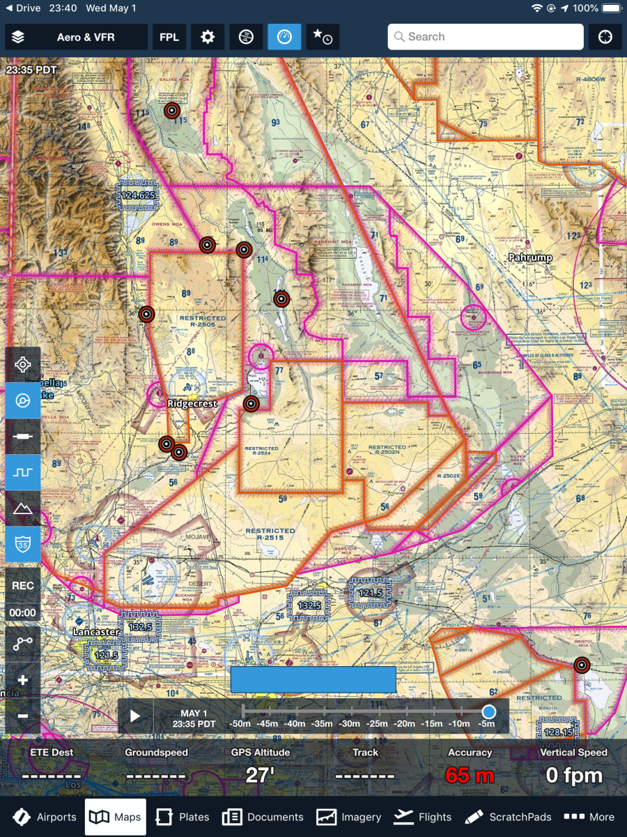

When you import it into the app it will give you all the airstrips as waypoints, shown below as dark red circles. It's easy to add them to your flight plan and use them to navigate to.

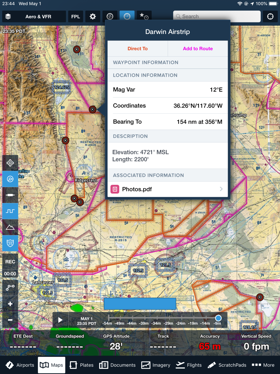

When you click on a waypoint it will give you a quick summary of the GPS coordinates and other relevant information like elevation, runway length and CTAF (if applicable).

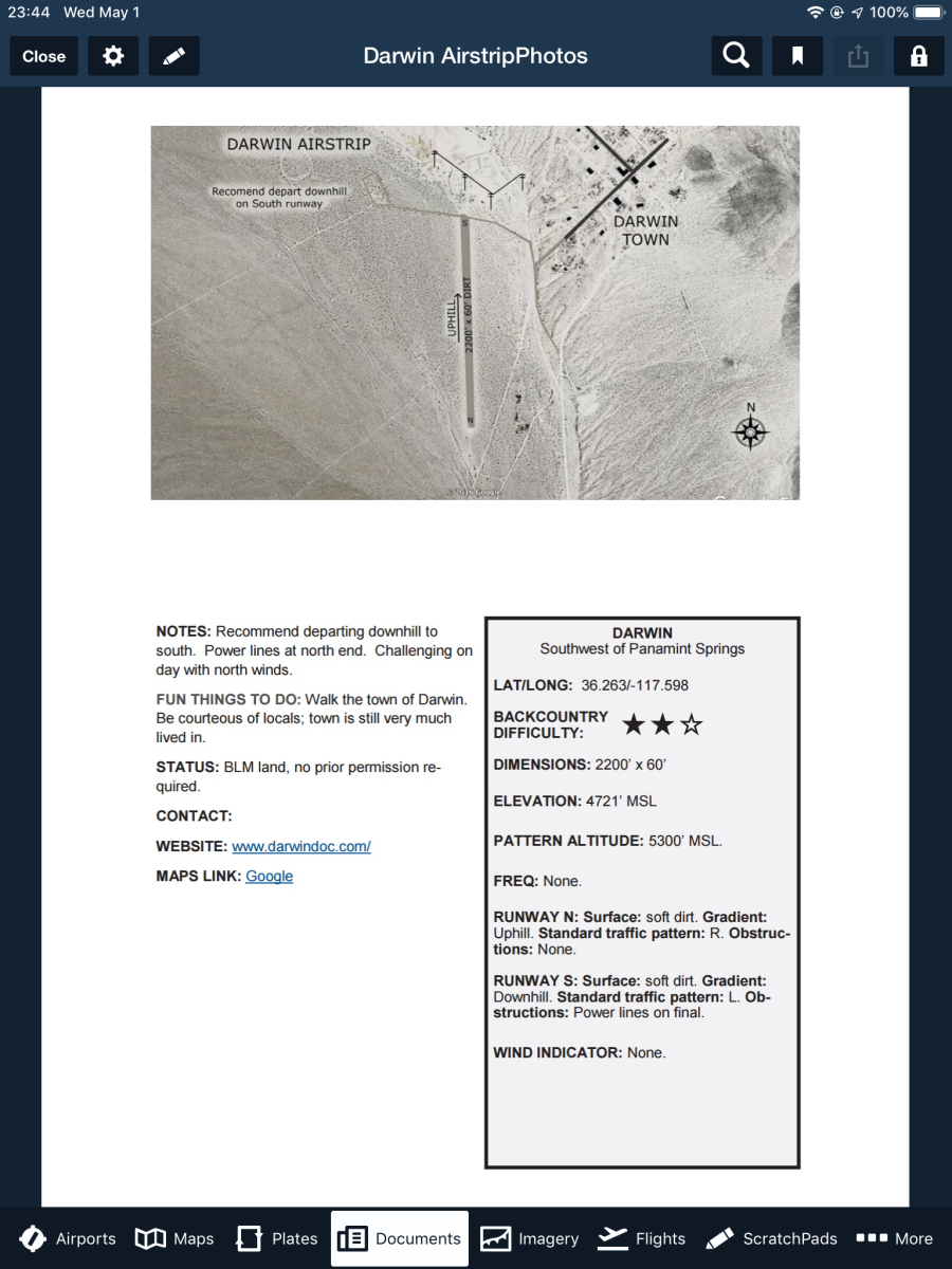

It also has a linked PDF for each waypoint. The PDF includes photos, maps, and more detailed information. Pretty much all of these are taken from Fiddler's document. It's easy to add to these, so if you have photos or suggestions, let me know.

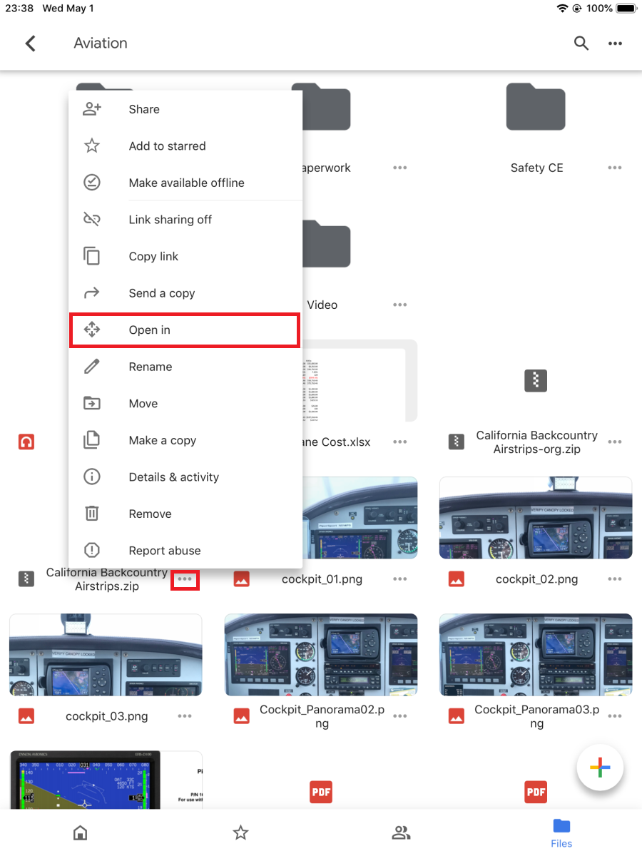

You need to get the zipfile to your iPad/iPhone, etc. You can do this by emailing it to yourself, adding to your iCloud, etc. The article I posted at the top gives you all the methods, I like to use google drive.
Click on the 3 dots next to the file then click "Open In"
"Copy to ForeFlight" should be one of your options

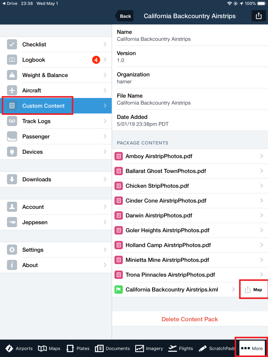

ForeFlight will let you know that it's been installed, click on "View"
This takes you to the contents screen. On this screen you can view the pack's version along with all the attachments, and delete it if needed. Click on "Map" in the lower right corner to take you to the map with all the waypoints. You can always come back to this screen by clicking on "...More" then "Custom Content"
