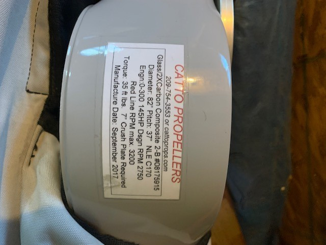

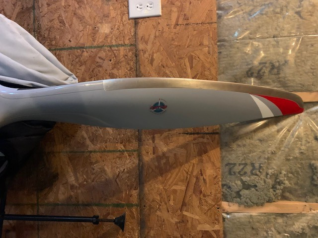

Now that my 170 will now be hiding a Lycoming 0-360 under the hood I have a Catto seaplane prop for sale off the Conti 0-300.
The sale could additionally include: crush plate, full spinner assembly and a padded prop cover.

Any idea if this can also be mounted on the C-145? Thanks!

Yes; that's what I had it on, not sure why Catto annotated the hub as 0-300.
