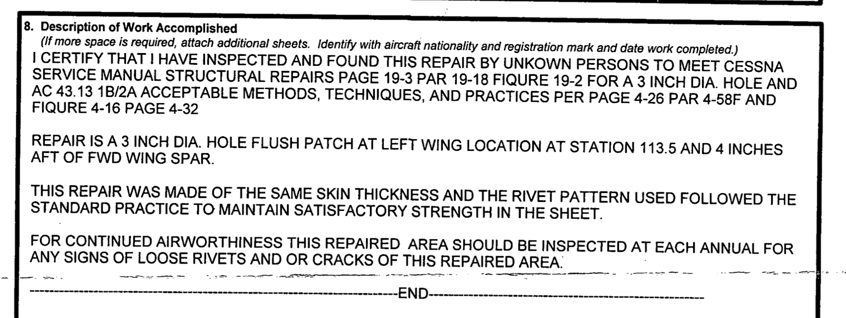

Thanks guys, great information. I hope this helps others.
As luck would have it, I just received the records (from AIC Title) of another aircraft I was looking at and lo and behold there was just such a 337 in those records.
I was impressed that someone would go to the trouble to clear up a small legal issue like this.
Anyway, so there is a way to fix these annoying legal issues.
I attached a screen shot of the 337. If it doesn't come through I'll do it another way.
Thanks again -
