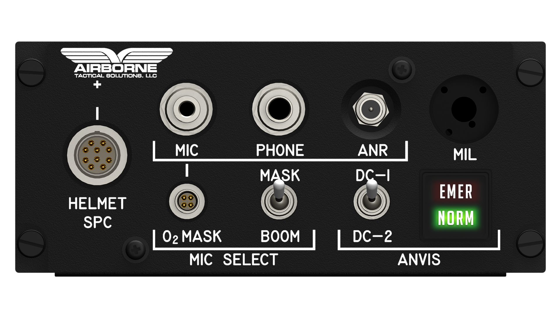

I have fought the problem of connections and impedance for many years flying Commercial Derivative Aircraft (CDA) (Civilian aircraft adapted for military or paramilitary use). Headsets were not generally a problem but helmets often were. Available military helmets were always U-174/U plugs with low impedance / Dynamic microphones and the lead time to procure modified helmets for overseas customers is long.
I started a small company and designed a box that will accept GA plugs, Military plug, and our proprietary "Single Plug Connect" (SPC). The unit contains internal impedance and DC power converters. The SPC connection powers all helmet mounted accessories (ANR, NVGs, helmet mounted lights) and allows all batteries to be removed from the helmet. While the Integrated Communications and Power Supply (ICAPS) is not aimed at the civilian market I thought it appropriate to the discussion. ICAPS has been installed as factory equipment in some ISR aircraft.

Wow, nice device. For every problem there is always a solution. Prfobably because all my previous headset purchases were directly through aviation, GA aviation, sources, this entire difference in plug thing escaped my notice. I can just imagine my chagrin if I had failed to get up to speed before ordering and my new headset arrived with one single larger plug #-o
