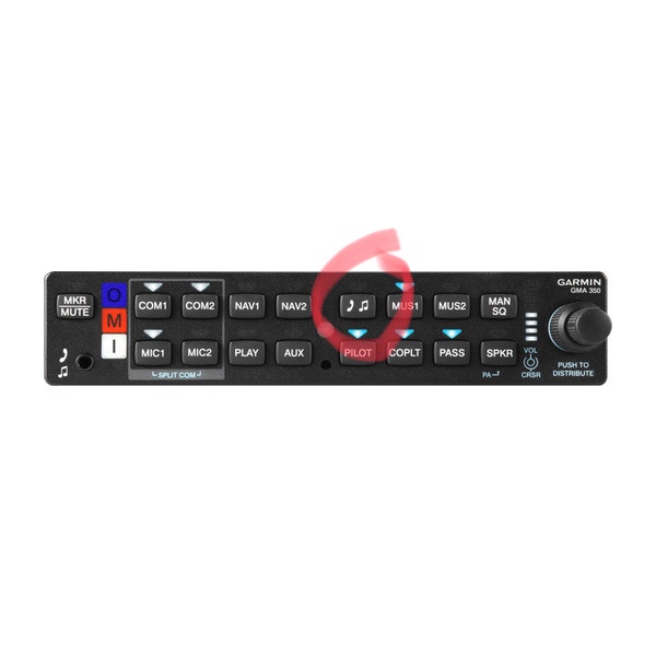

To get my XM / 796 combo to play properly, I have to do everything mentioned so far and also select the music input on my intercom / audio panel.
