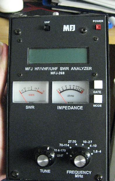

Several other people have pointed out how important antenna type and placement can be, and things like SWR or standing wave ratios, resonant coax lengths, and more can affect signal input/output. If you can borrow one of these “antenna analyzers “ from a ham radio operator, you can actually more effectively judge/estimate a resonant cable length for connect a remote window or dash antenna to your hand held transceiver.
MFJ Antenna Analyzer using old fashioned analogue needle and meter output display (sort of steam gauge)
MFJ Graphic Antenna Analyzer up to 180 Mhz with digital display.
