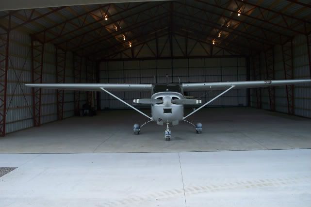

If you are in the market for a different brand of building, I had good luck with MiracleTruss http://www.steel-buildings-direct.com/w ... truss.html . It is a steel building that uses wood purlins. We put up a 72 X 48 ft building ourselves and it was not all that difficult. The building material is quality and everything fit. The company does have people available that put these up if one chooses. This was the only picture I have at hand of the inside of the hangar.
