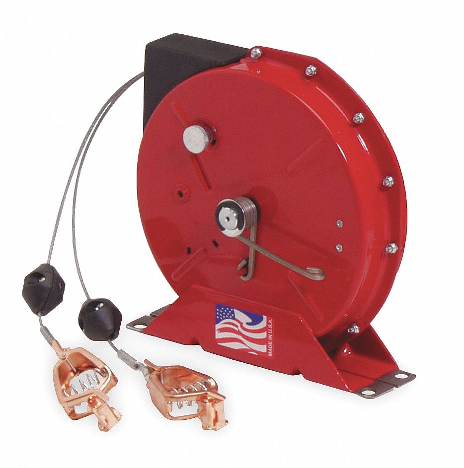

For my trailer setup I got a static discharge reel with two leads, similar to the one below. I clamp one lead to the airframe, and the other to a grounding rod at my tiedown. The reel itself is bonded to the tank and the trailer.
-DP
