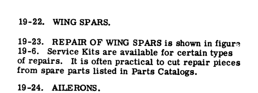

UcheeCreekAviator wrote:Hardtailjohn,
Cessna repair manual states that a repair of that magnitude must be done in a Cessna wing jig to ensure wing twist remains correct.
Really?
It's not a hard repair.
Screen Shot 2020-01-12 at 2.32.45 PM.png (83.7 KiB) Viewed 3018 times

Doing wings is a bit of an art. Some folks do it quite well with or without jigs. It is absolutely a great idea to participate with somebody that actually knows what they are doing. Even if it costs a bit more, the education is priceless. There is a trick to closing them that needs to be learned. Planning the entire process is an experience based procedure, not covered by books or schools. We did lots of wings in our shop, from Small one to Twin Otters. Each one had a different approach. Now in our shop we actually had a sign, "Labor $105 per hour, $140 if you watch." I would have recommended the repair station I used to own, which was in Georgia, but I have no idea of the work being put out now, I am 5 years out of date on it. One of the most experienced tin benders retired, 40 years of experience. You cannot reproduce what he knew.
The Cessna spar repair is based on several different kits, depending on what part you need to splice or repair. Any IA can sign it off. It is a major repair. However, any A&P can do the work. It is not magic, just something most folks never get experience doing, since most places will not attempt to take on that kind of job, due to lack of experience. Good tin benders are getting hard to find. That and most insurance companies are totaling out most aircraft with that kind of damage. So building up experience is getting hard to do.
