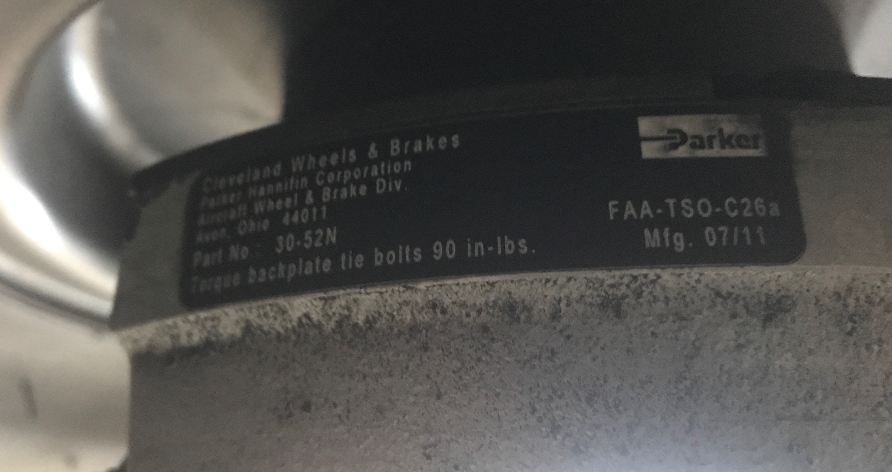

In some remote corner of my brain is a memo that says the only difference in the 30-52 and the 30-52N is the clocking of the torque plate or a pin length difference, but the caliper bodies are identical. ymmv
fyi, you certainly can buy new tags from parker......

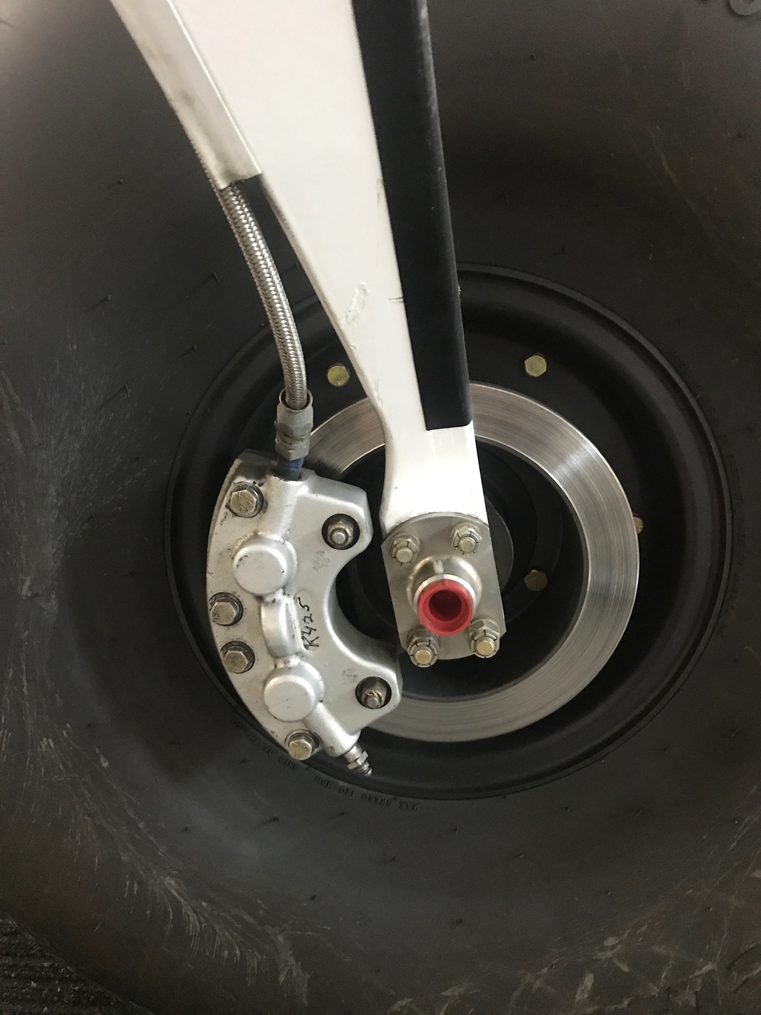

doc_dyer wrote:would like to know what brand these are, just because my paperwork says they are X I want to verify that they are X
Thanks in advance,
Bradley
Too many threads showing on those axle bolts???

C180_guy wrote:Too many threads showing on those axle bolts???
They may have rusted off to the correct length by now :)

Is more proof needed or have we moved past that?
