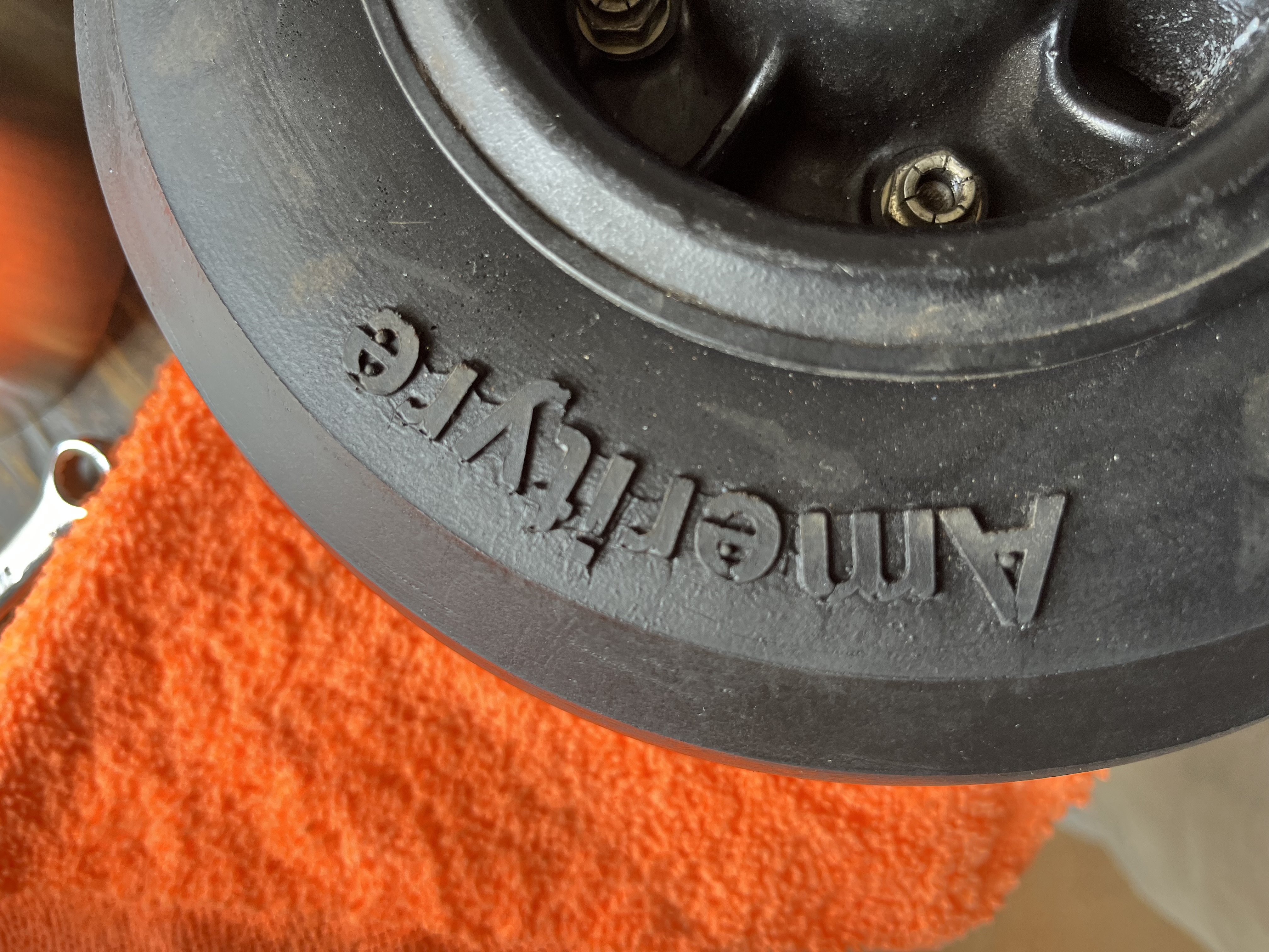

Regarding my experience with tires during my trip, I already mentioned the Desser 8.50’s, which are perfect for my mission.
As for the tailwheel, my bird came with the ABI wide fork and a 4.00x4 glider tire with tube.
Compared to the Baby Bushwheel, which also fits in the wide fork, the glider tire is about the same size, but costs a lot less and some people claim it handles better on hard surfaces.
More flotation on soft surfaces (deep sand, wet ground) is the reason to swap out the Scott 3200 tailwheel. However, on the backcountry strips I landed on, I haven’t encountered conditions where tailwheel flotation was an issue, and I’m not interested in landing on wet sandbars.
Having experienced occasional shimmy on tarmac, I feel ambivalent about its usefulness for my gentleman-like approach to backcountry flying.

A wide tailwheel doesn’t quite fit with 850s in my opinion/experience. Once you’re in 29/31/35 territory, and are using them as intended, the wide tailwheels are necessary and awesome to have.
When I’m on 850’s, I switched to running a solid tailwheel tire called amerityre. It’s high density closed cell foam rubber, not hard solid rubber like the old style. They’re great. About as much cushion/give as a fully inflated 8” pneumatic tailwheel, and zero maintenance. $100. Handles anything the 850s will. Then put the wide fork on when I have on wide mains.
I also find the ironic spelling of Amerityre to be funny. Made right here in the US. With British spelling.
Posts: 1532
Re: How did she do? Thoughts about my 170 build
asa wrote:They’re great. About as much cushion/give as a fully inflated 8” pneumatic tailwheel, and zero maintenance. $100.
Im not sure the use of a handtruck tire on a “certified” aircraft is the best idea… LOL

asa wrote:I also find the ironic spelling of Amerityre to be funny.
I also had a chuckle.
https://amerityre.com/our-flat-free-pro ... uck-tires/
Was going to say more, but, you're right, it's probably right up there with a glider tire clearly labeled "experimental use only". I thought this was a safe space after seeing he was running that.
140eagles wrote:As for the tailwheel, my bird came with the ABI wide fork and a 4.00x4 glider tire with tube.

asa wrote:Was going to say more, but, you're right, it's probably right up there with a glider tire clearly labeled "experimental use only"
Im pretty sure Wolf’s Cessna is not a Maule… LOL
Safe space yes, but I was just pointing it out as there are a lot of folks who read BCP and it sounded like you were suggesting that was an acceptable substitute.
As far as the glider tire goes, the basis is the STC.
