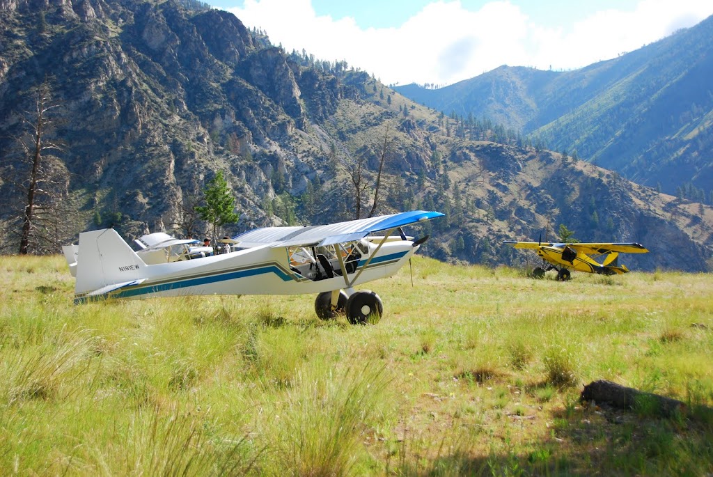

As stated, the 100hp Rotax 912S in a Rans (or highlander) is a super performer in these ~750lb airframes. Mine has operated in the high desert, Idaho, Sierras, etc. and it performs as good or better in terms of climb, take-off roll, and landing as all but the most modified/hopped up Super Cub.
Make it to JC in June, and you will have the opportunity to sample it first hand - there will be several S7's there, probably a highlander, kitfox, etc. Also as debated at length, it really just depends on your mission, your budget, your time, etc.
I would love to have a carbon cub EX. But I can't afford it, and it will cost me 2x or more in fuel cost/hr to operate. The Cub kits that I have seen will all run you quite a bit more money than a Rans or Highlander Kit. There might be exceptions to that. But hey, if money is not an issue, the guy that has my old S7 also owns the prototype Carbon Cub EX with the 220hp motor and flames that's for sale! That thing will do just about anything! In fact, he's in Wyoming, and owns/has owned several S7's, exp Supercubs, Mackey SQ2, Carbon Cub, etc. - HE would be a good guy to talk to about what they will all do.
I love the Patrol. I really love the Bearhawk Blackrock. My dream would be to find a reliable partner that we could have 50/50 share of my Rans and a Bearhawk. Talk about best of both backcountry worlds!!
So, my choices for a 2-seat tandem cub-type KIT:
Money no object: Carbon Cub or Mackey SQ2
LSA-type Kit: Rans or Highlander
Time not object/longer build: Patrol
