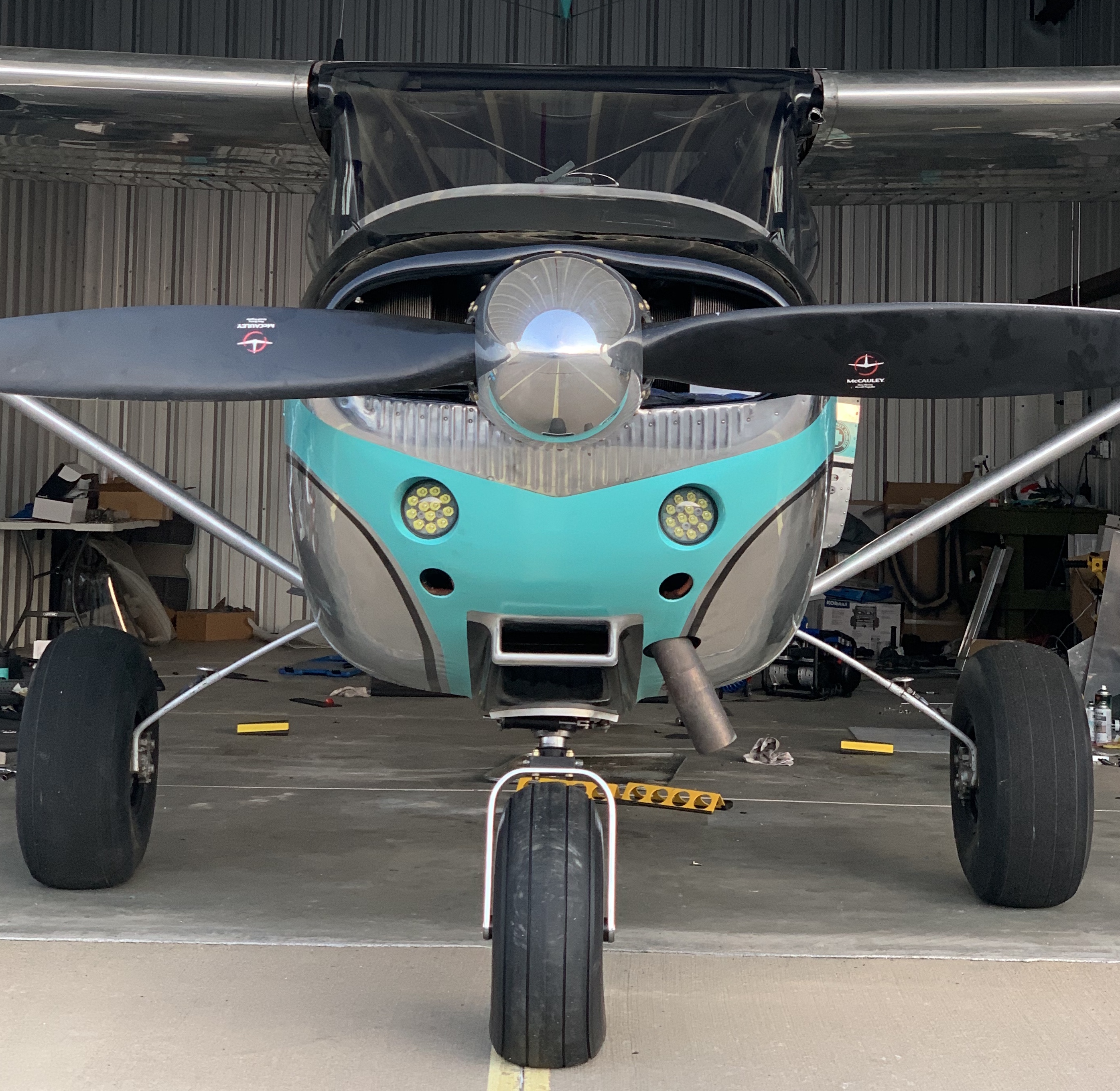

For the same reasons you stated I wanted to add cowl lights. I did it for both looks and on airport. They made a big difference in taxi around a dark airport at night. This is a 182A model so the cowl bowl is slightly different then yours, I believe you will actually have more room on the engine side.

Re: Landing light location change
I'm not a fan of nosebowl mounted lights, but that installation looks really good.
And probably provide very effective lighting.
