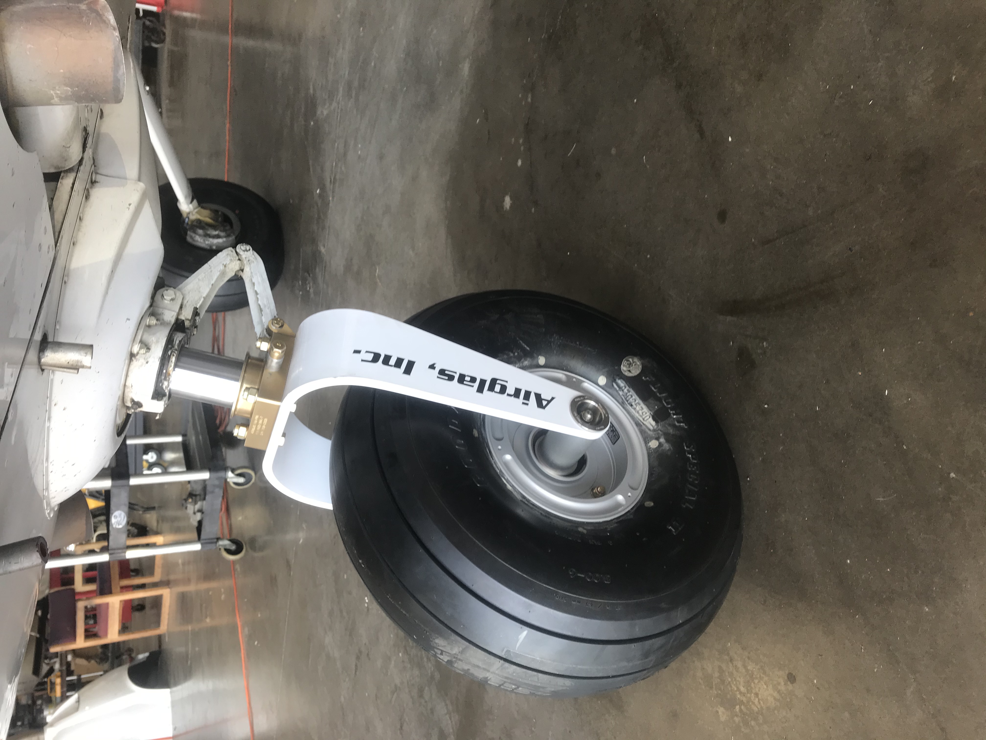

Does the AirGlas have provisions to use the factory towbar?

I’m not sure what a Cessna factory tow bar is like but the airglas has the two bolts sticking out about 3-4” above the top of the tire to which a normal tow bar easily attaches.

@pipeliner, when I was flying a lot of 207s I sometimes got one that was hard to taxi. Adding a little bit of nitrogen to the nose strut would extend the strut a bit, and taxiing would be much easier. In your first and second pictures there isn’t much strut showing, and I think you would benefit from increasing the nitrogen charge. In the third photo there is quite a lot of strut showing, so maybe you’ve already taken care of the problem.
Also, to anyone planning to operate their nosewheel Cessna on rough surfaces, you might want to consider clamping about 2 1/2” of heavy rubber hose on the bottom of the strut cylinder. It will cushion the blow when you don’t see the pothole in the runway. Just about every Cessna operating in western Alaska has this mod.

Thanks! I hadn't made the connection, but that makes sense. I appreciate the feedback. Actually, all of the photos with the tow bar were taken on the same day and are the most recent. The nose strut was just recently recharged as it had gone completely flat, but that was before the photos with the tow bar were taken.

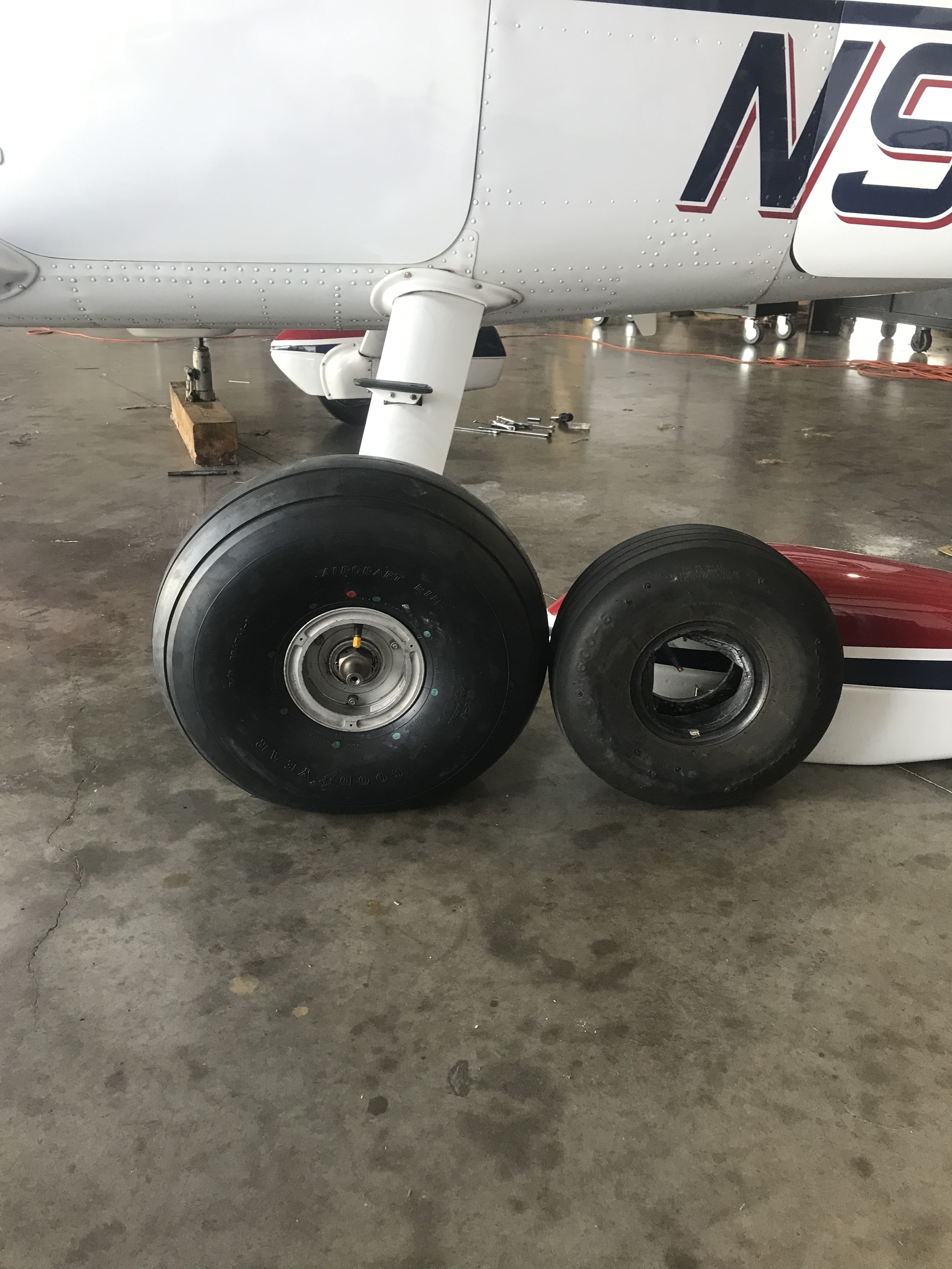

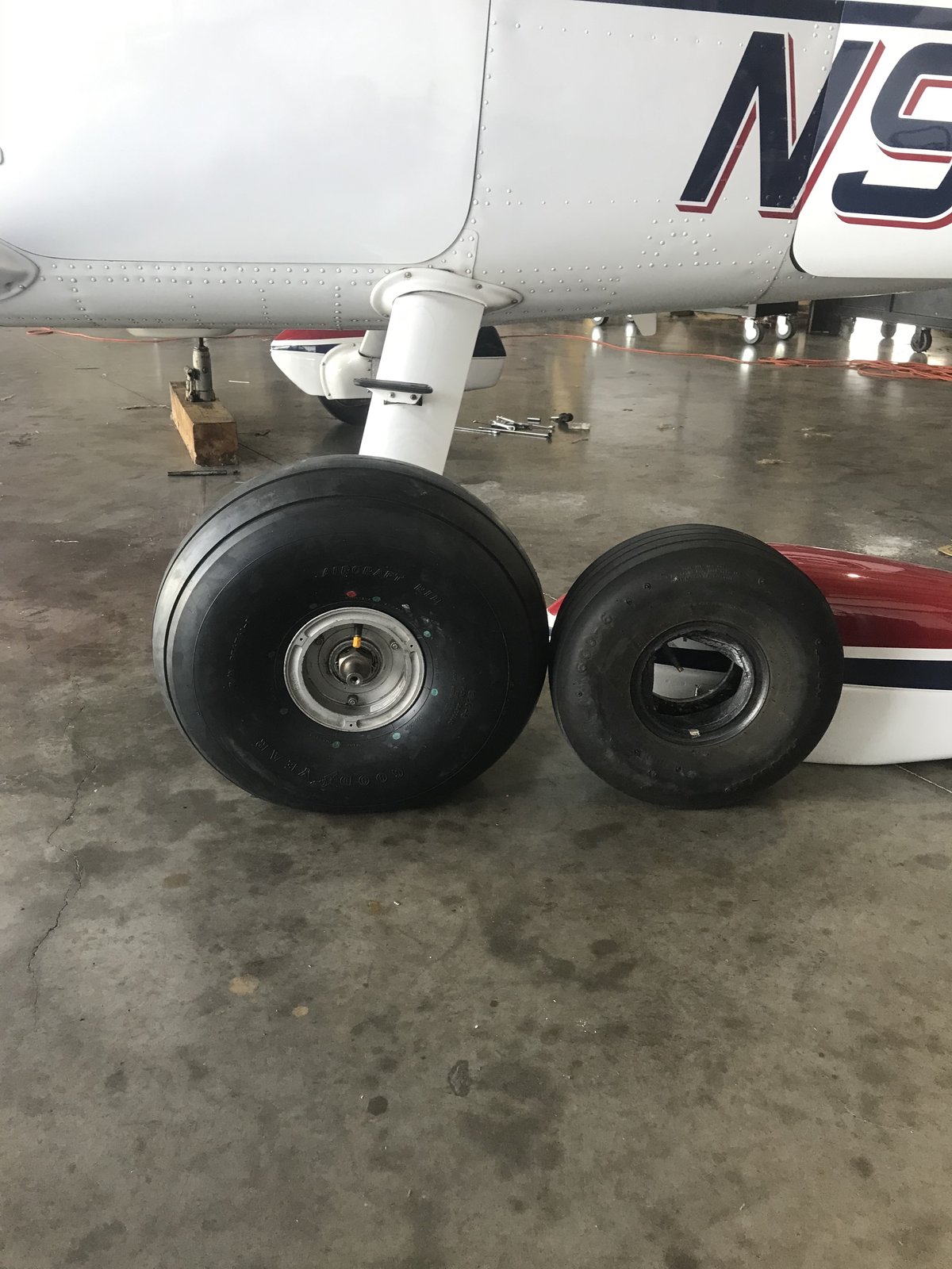

Things are in motion.
Mains are going on today.
8.50 x 6 on the left and stock 6.00 x 6 on the right.
Pretty Stoked,
D.

Looks Great!
Two things:
1) Atlee dodge sells 1/8 in spacers to put between the brake disk and the wheel to give more room for the brake pads. you need 1/8 inch longer bolts for that, AN5-36A is what I used.
2) You can change out your wheel nut, which has the bolt hole for the wheel pants, with a slimmer nut. Then you can add hub caps to help keep the dirt and grime out of the wheel bearings.

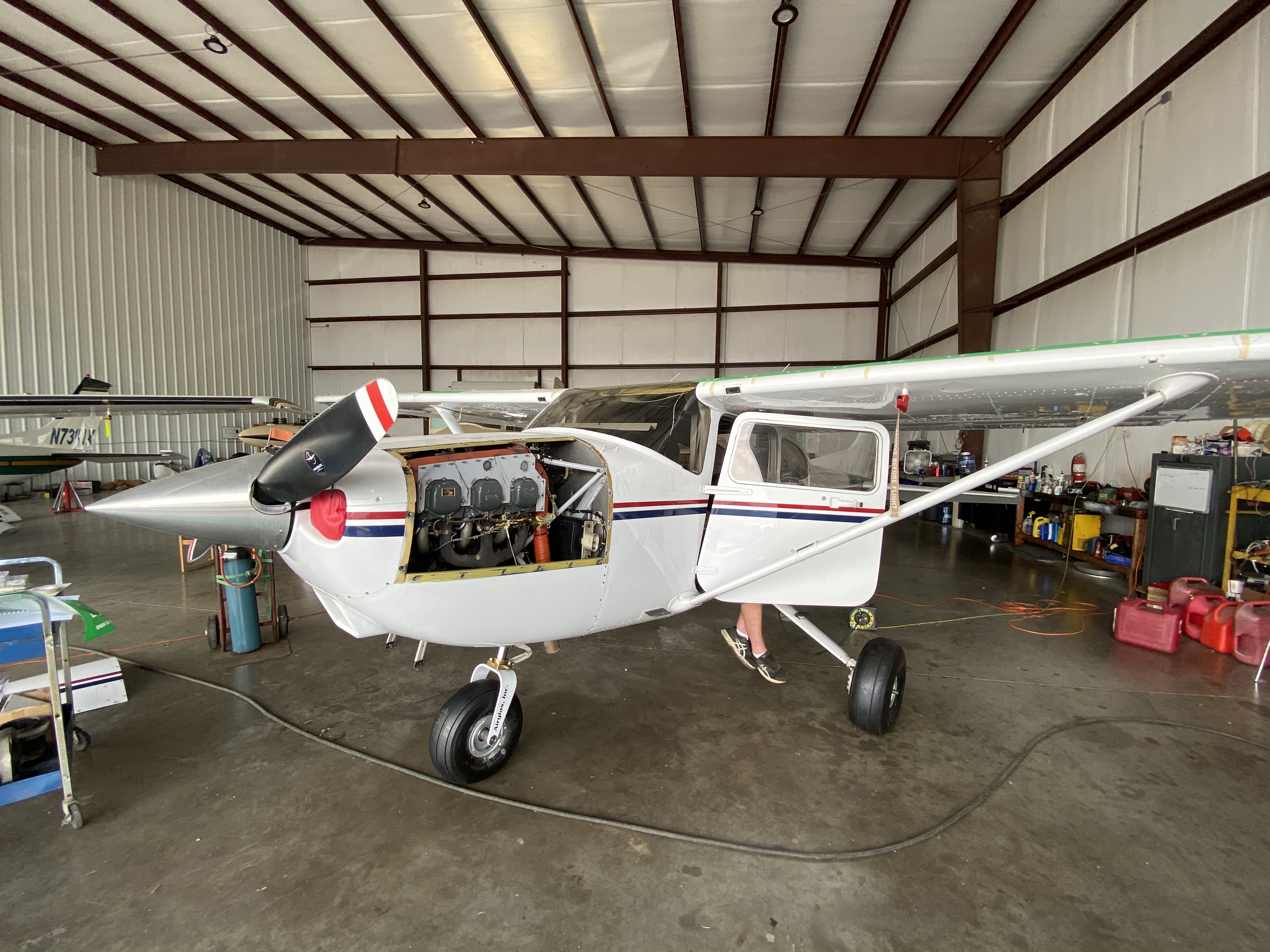

Finally got to see the plane in person. Those spacers are a good call. Ordered them today.
They were working away on the VGs and BAS belts.
Hubcaps showed up also.
D.
