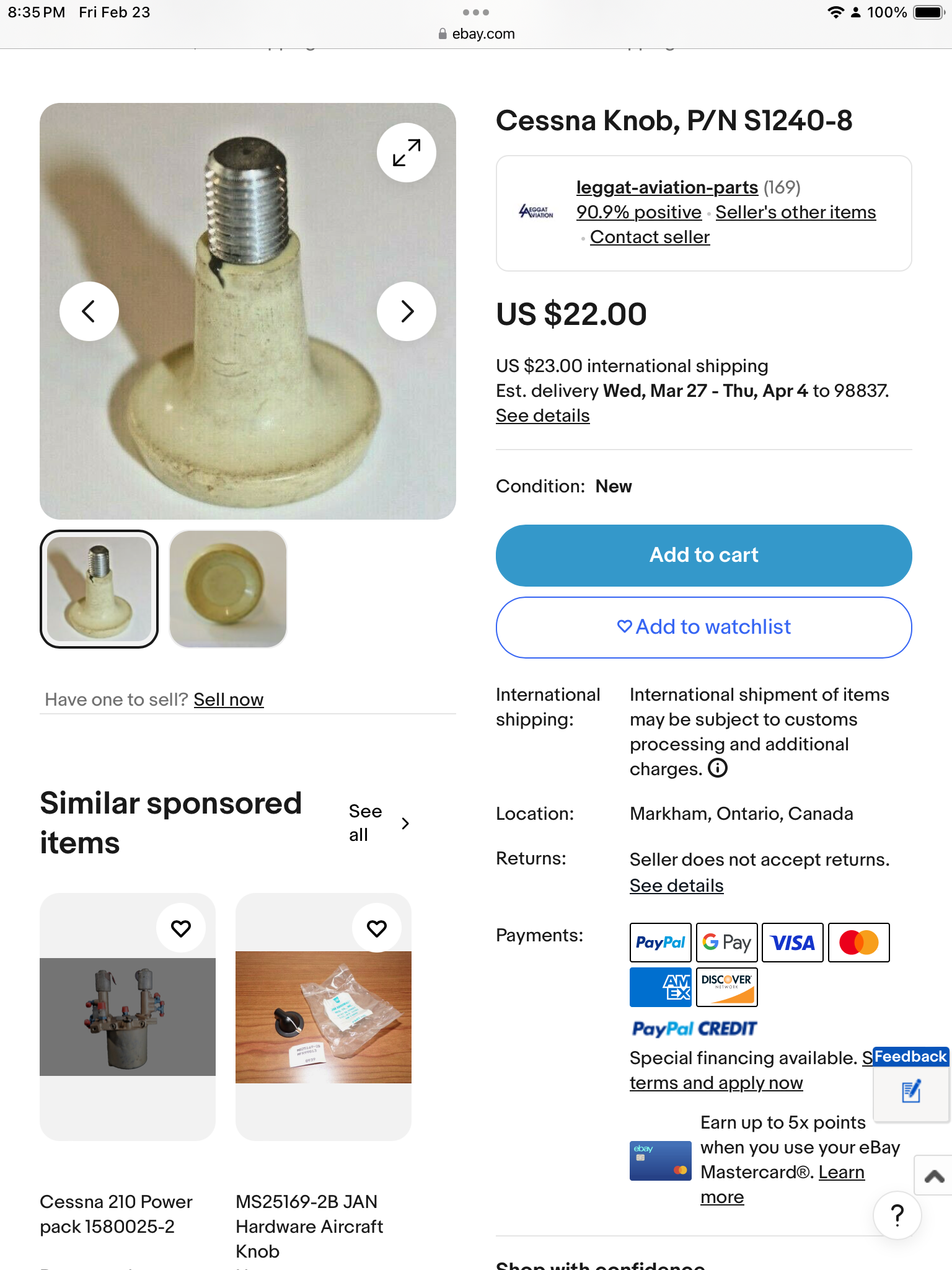

The re-searched and found the image that got threads into my head, turns out it is a slightly different part number.
I think I’d try making something metal and using small set screws to secure it.
