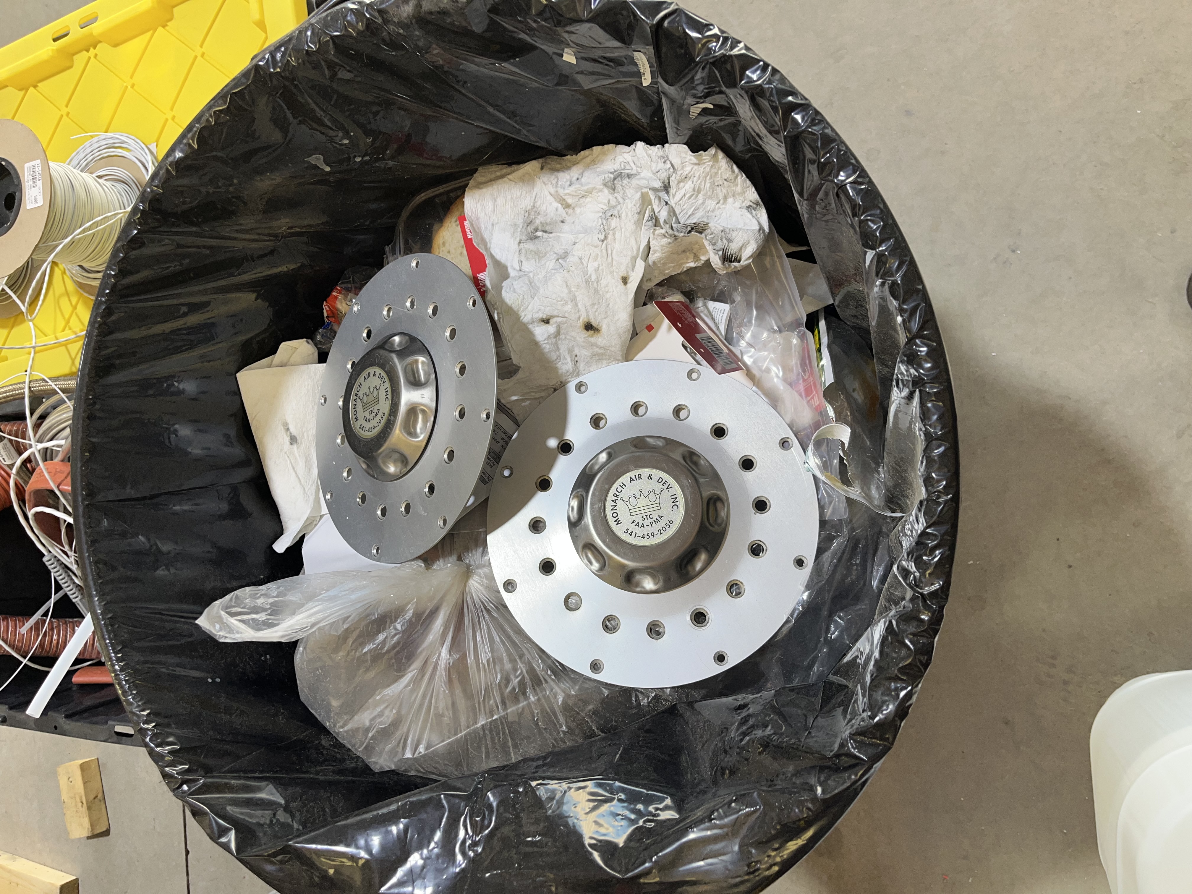

Like many of you I have battled leaking monarch’s, gotten uhh….poor customer service from Hartwig and was told over and over I am doing something wrong. Well I finally fixed the problem. In all seriousness, could never top off or the wing would spew a cloud of avgas behind it. Removed them, plated the holes. For the Cessnas with factory long range tanks, these will take care of you for way less than the $7k Textron wants for a set of caps. P/N should be 1220022-3, FYI…double check your IPC but these were pretty universal.

S.patJ3 wrote:Like many of you I have battled leaking monarch’s, gotten uhh….poor customer service from Hartwig and was told over and over I am doing something wrong. Well I finally fixed the problem. In all seriousness, could never top off or the wing would spew a cloud of avgas behind it. Removed them, plated the holes. For the Cessnas with factory long range tanks, these will take care of you for way less than the $7k Textron wants for a set of caps. P/N should be 1220022-3, FYI…double check your IPC but these were pretty universal.
I’m certain this pic is staged for the sake of making a statement. Those are worth too much on eBay to just toss in the round file.

I was hoping to inspire a laugh or two, but in all seriousness these assemblies have had their final flight. I hope there is a definitive answer to these problems at some point. More options for these old airplanes is always a good thing.
