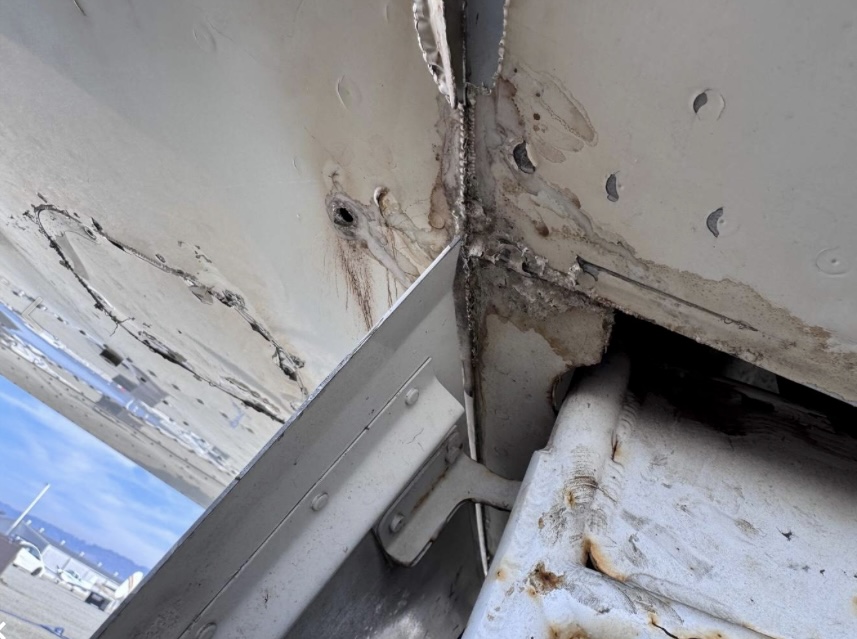

Guess it’s no bueno for wet wings ether, causing the tanks to leak fuel after adding G100UL
“ General Aviation Modifications Inc. is inviting an operator of a wet-wing Mooney to visit Ada, Oklahoma, for a borescope inspection to assess the condition of the sealant in the tanks. "I would like to have the chance to borescope an older Mooney fuel tank that has not been converted over to a bladder," Braly said in a post on mooneyspace.com. The invitation was extended after two California owners reported issues with fuel leakage after putting GAMI's G100UL in the tanks. The fuel is available at three California airports.
Mooneys and many Pipers were not factory equipped with rubber bladders in their fuel tanks. They were formed in the structure of the wing and a sealant used to fill the voids and rivet holes in the metal. Many older Mooneys started leaking when 100LL was introduced and owners either installed bladders or had the tanks resealed with a "sloshing" treatment developed in response to the widespread problem.
One of the owners reported on mooneyspace.com that his tanks started leaking a week after he started using G100UL. Another said his tanks had been seeping (within manufacturers limits) but when he added G100UL the paint blistered in the areas affected by the seepage. GAMI founder George Braly told AVweb it's not clear what role, if any, the fuel is playing in the issues but he did say the formulation is different from 100LL, notably in its use of an aromatic chemical called Xylene to boost the octane and hence detonation resistance of the fuel. Aromatic amines are solvents, but Braly said in a detailed response to the posts it's the least aggressive of the octane-boosting chemicals. He also noted that the sealant in the tanks is likely decades old. "It lasts a long time but it doesn't last forever," he said.
Braly said the fuel has been exhaustively tested on sealants, seals and gaskets used in airplanes under the supervision of the FAA. He also said he's never seen it cause paint to peel. If spills are not cleaned up, it can cause a yellowish tan stain. Many of the responses to the thread on the forum said they were not having any problems with G100UL.”

On BT, Braly claims they did do testing. However, now we have the AOPA Baron develop leaks in the G100UL side, the Champ on BCP with the stripped paint and now the wet wing Mooney develop leaks. On this morning's Avweb news Braly's competitor at Swift Fuels had this to say,
"Similar damage has been witnessed, photographed, and reported to the aviation industry over the last several years with fuels containing aromatic amines. This leaking of sealants, staining, and stripping of paint in this fuel is most likely caused by meta-toluidine, an aromatic amine - and a very aggressive solvent - contained in G100UL according to the safety data sheet and the FAA independent specification. For clarification, Xylene mentioned above is not an aromatic amine - it is a C8 aromatic hydrocarbon also generally described as a solvent.
Chris D’Acosta
CEO - Swift Fuels, LLC

This whole unleaded issue is very, very complicated with all the parties involved. I ran a tank of G100UL as you can see on my PIREP #1 and PIREP 2 on the RHV G100UL locked topic. I do NOT want G100UL to be the "winner" of this issue and do not want two "winners". G100UL stains and does not evaporate and I do not care for the turpentine smell. I have a mason jar of Swift 100R, and it does NOT stain, it evaporates and smells a bit better - like nail polish. I also found G100UL stains 16 - inches x 2 - inches wide aft of my oil breather on the belly. Took compound to remove. Court action in California is going to try to legally push four distributers to handle the G100UL per an agreement made years ago when unleaded fuel becomes commercially available. https://www.avweb.com/aviation-news/g10 ... rt-action/
