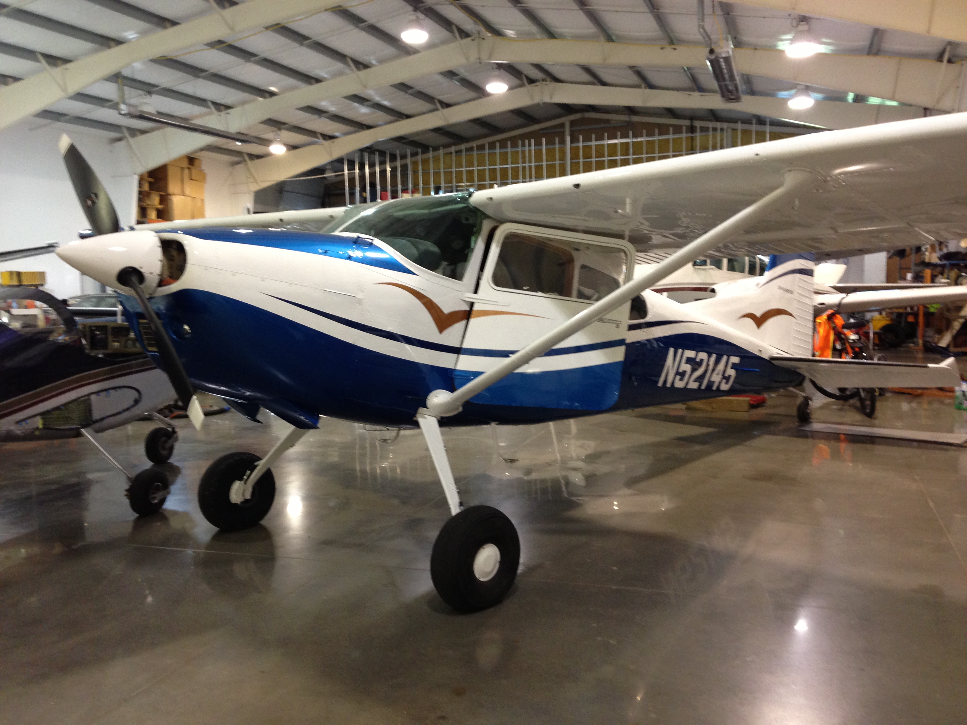

I'll post some better pictures once I get the plane home. My buddy's hangar where we've been working is 35 miles from where I live. I'm so tired of that drive! I kept telling myself ' there is no deadline ' , I didn't want to take any shortcuts. The next project is the headliner and finish installing all the interior.
http://www.themud.com/blake/cessna1.jpg
http://www.themud.com/blake/cessna2.jpg
http://www.themud.com/blake/cessna3.jpg

jkOregon wrote:I'll post some better pictures once I get the plane home. My buddy's hangar where we've been working is 35 miles from where I live. I'm so tired of that drive! I kept telling myself ' there is no deadline ' , I didn't want to take any shortcuts. The next project is the headliner and finish installing all the interior.
Hey your tail # is apparent in that top photo... looks like you wanted it blocked from the earlier photos-

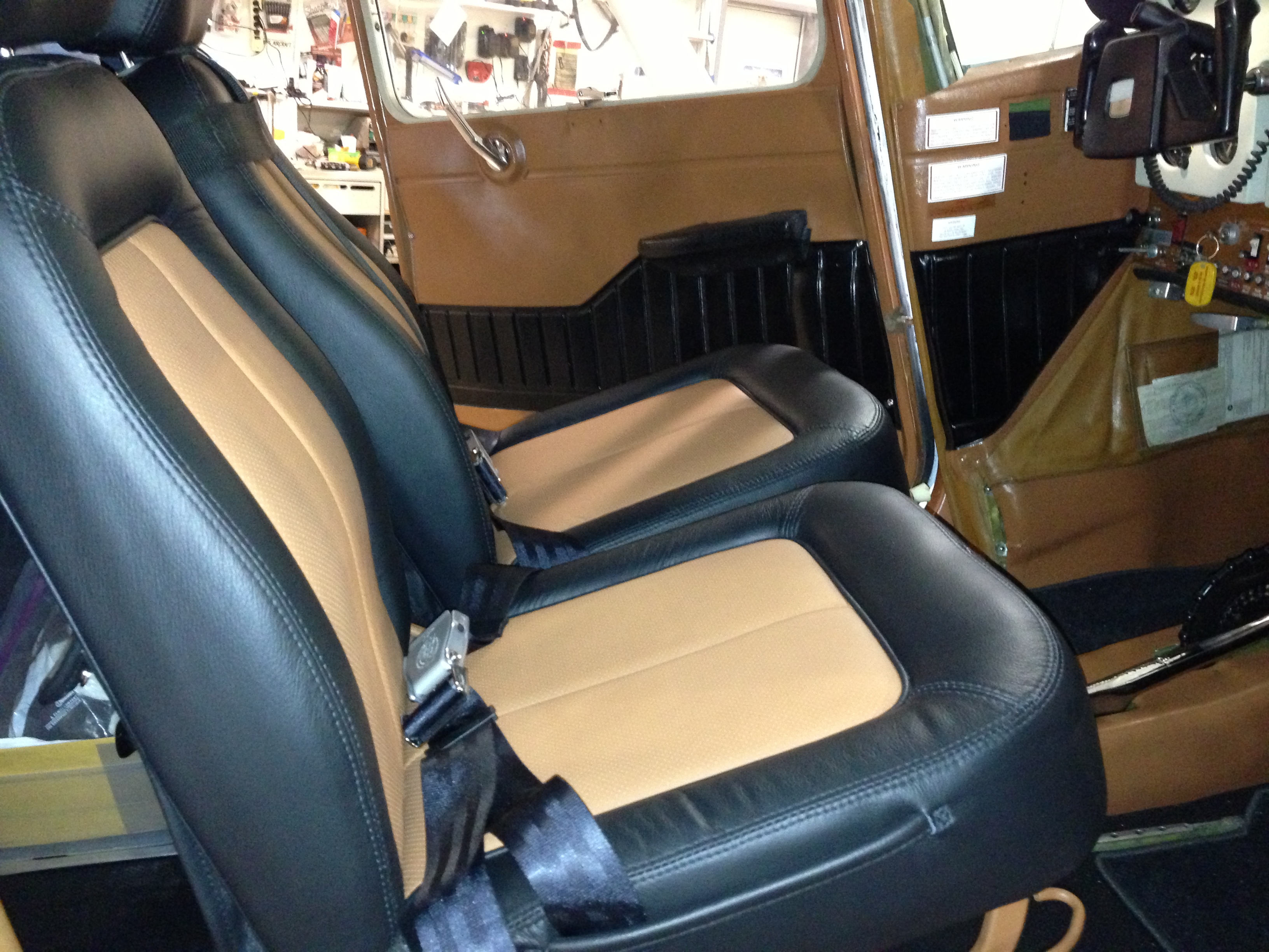

It's been a tough summer, my Dad passed away earlier this summer, a positive note I was able to spend some quality time with him the last 6 weeks of his life. I wasn't able to get him in the Skywagon for a ride but he loved following the progress.
Here's some pictures of the headliner install. Thanks Barnstormer for the tips!
