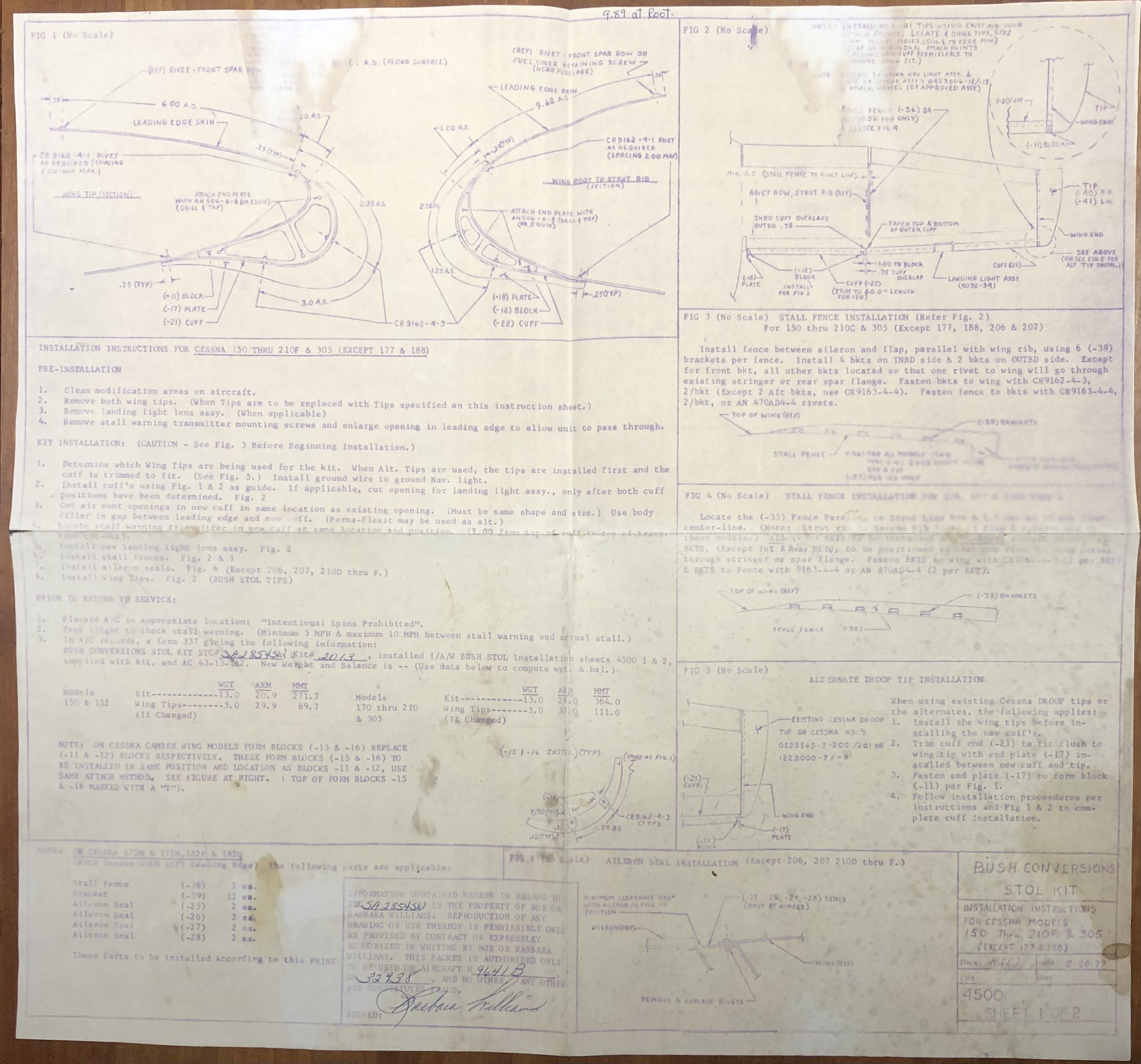

Not the best photo but let me know if you need a better copy

I didn't even need this but that's pretty amazing you found that! Awesome!

Thanks RC5280, I tweaked the contrast and color and added it here:
https://backcountrypilot.org/knowledge- ... 72-skyhawk
under the "Wings" section.
