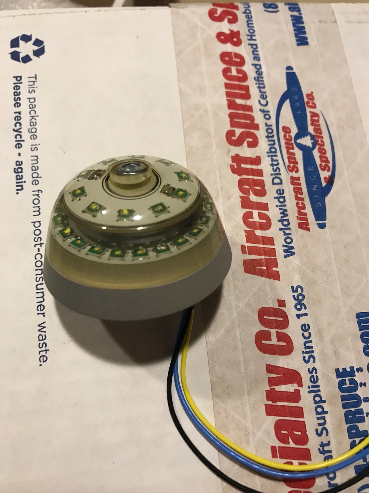

I’d stay far away from Aveo...
I used to be a big fan of their stuff, but no more. The product sucks and customer service is even worse. Aircraft Spruce can suck it too, but I’ll stick with Aveo for now.
I bought that exact light, from that exact place. It arrived looking like it had been in storage for 30 years. The “lens” or resin or whatever they want to call it had yellowed. Aircraft Spruce wouldn’t help me, and I went back and forth with Aveo once I finally found someone to talk to but also got nowhere. I still have it, ugly and yellow. F-them.

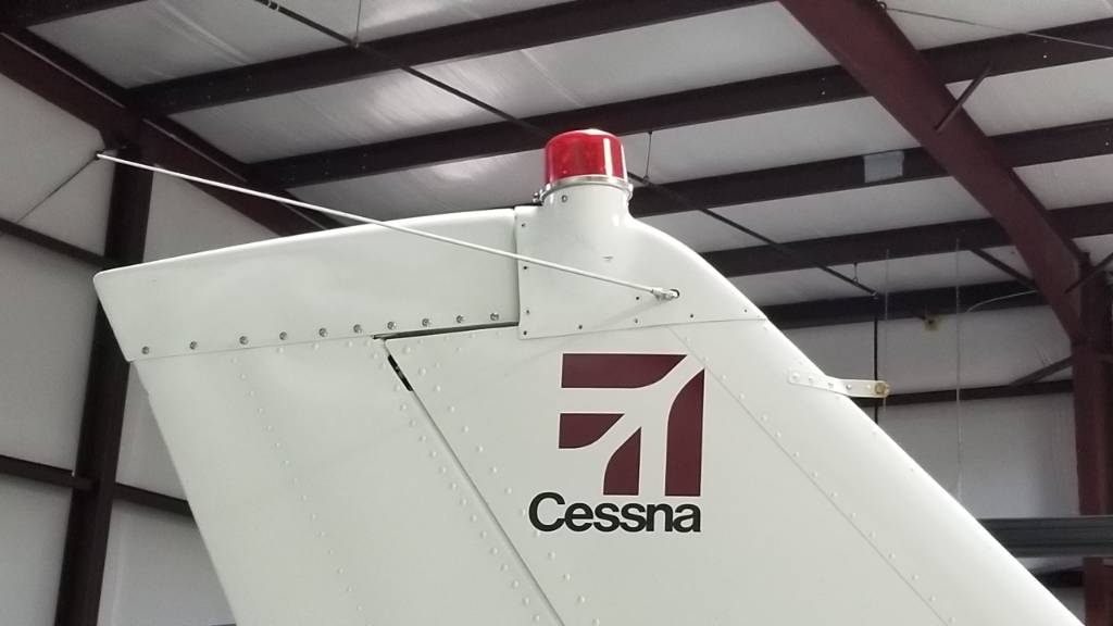

Those smaller beacons / strobes / whatever look a lot better atop the tail than the big old Cessna "jelly jar" lights.
That is a really good location for a strobe /beacon if you're just gonna run one--
very visible from a number of angles.
My C150TD had an Aeroflash strobe on top of the vertical, with a cap that kinda faired it in, looked really good.
I wouldn't mind something similar for the C180 but I haven't ever seen one tat really appeals to me,
due to the rudder counterbalance there isn't much room on top of the fin.
Here's a photo of it (after the guy I sold the airplane to repainted it):
