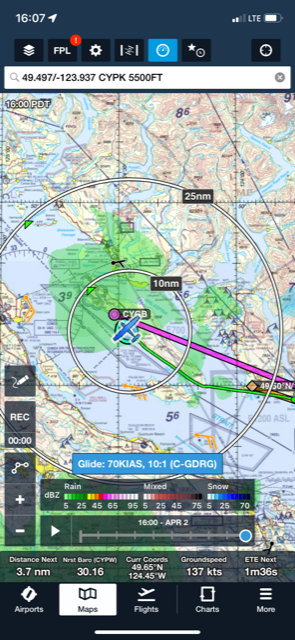

daedaluscan wrote:Not sure I get 114 at 6gph. I have a Hartzell 78". I plan 105kn at 9gph.
This was level with maybe 25 kn push at 24 squared.so maybe 110kn.
Is that the Foreflight app ?
Re: O-300 or O-360 (C170B)
Yes, Foreflight. A bit $$ but it is amazing. Worth it for me. I love the weather, and in the USA that comes in on Stratus. In Canada by cell. Planning. CFS. Up to date charts. You can overlay ceiling, wind, radar, 100LL prices, visibilty (awesome when its smoky) AHRS, synthetic vision, profile….
