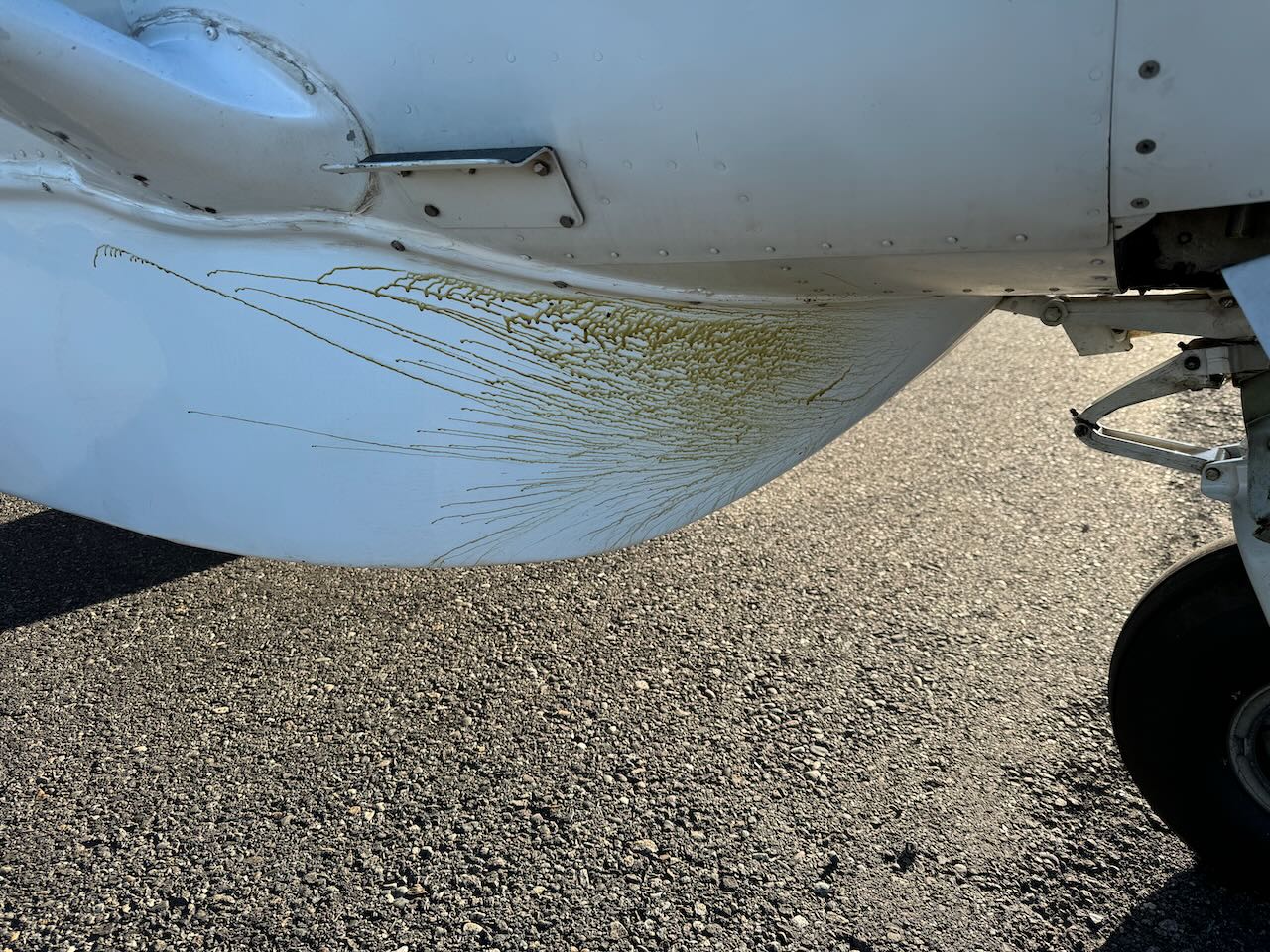

Here's one for you.
I made the EXACT same short flight the very next day. And here is the result. A little confusing. Someone suggested to me it might have been a temporarily stuck ring?

Sometimes after a 3 1/2 hr flight I’ll land with almost no oil showing on pod . Sometimes it looks just like your first picture you posted . I do know that there is a sweet spot when the oil level is around 9 qts or just under where it will stop splooging out the breather .I try to run that level if I can . I’ve got about 250 hrs on overhaul and burn almost no oil . A little bit of oil can look like a lot .

I'm with Zzz on this one, I'd say the oil level for the previous flight was just a tab about it's "happy" level and you blew a bit overboard.
