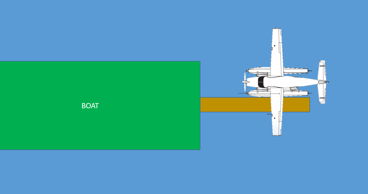

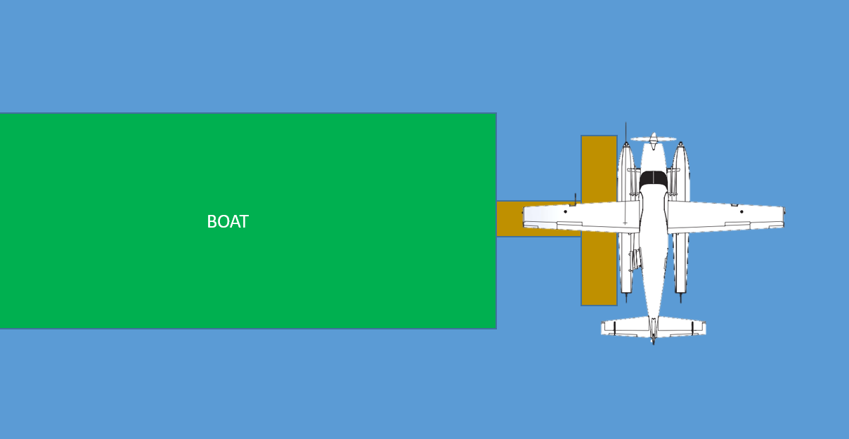

Caravan can load from either side, so a U-dock seems unnecessary and complicated. Why not keep it simple?
If you take this sentence seriously: "By procedure, we will ensure that weather conditions and sea state support the transfer.", then this is really no different than docking a floatplane on a land-based dock.

Thanks for the reply and information, it was very helpful. Our logic with the "u" shaped dock was plane security, as the pilot will likely be staying onboard overnight and departing the next day.
Now that I think about it, and given the information you and MTV provided, if the plane is securely moored a T-shaped dock might be the easiest and safest option.

If your clearance is as you note, and depending on obstacles astern on vessel, you may be able to bring the wing over top of the aft deck. That would be ideal, frankly, because most any larger floating “dock” is going to be VERY cumbersome to bring aboard and stow…..remember, this has to be a FLOATING contraption, so requires floatation, read LARGE.
So, if you can put a wing over the aft deck, with a, say six or eight foot wide dock off the stern, and bring the plane up perpendicular to the vessel, aft……might be simplest. That’s what I did with the Beaver loading drums, though we never used any “dock” there.
In that case, and most others, your pilot is going to have to be skilled. You DO NOT want to get your jet driver float rated and put him/her in that Caravan for this deal. Bringing a plane up to a vessel requires some skill and a lot of currency.
