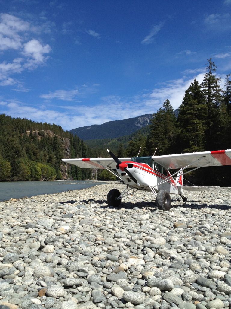

Battson wrote:Image
Great photo! I recognize BSH, the owner used to post on SC.org or the SWP site (or was it here?). As I recall, he kinda balled it up a few years ago & quit posting, but it sounds like he's back in action.

Re: Pacer Bush Build???
Those NZ Pacers are nicely done and beautiful airplanes!
This is a Pacer (22/20) that we modified over time. I really enjoyed this airplane and was considering spending 30-35K to put a Lycon 0-360 and MT prop on it.......the problem with Pacers is that the market only really supports a 25-35K airplane, so if it is not your final airplane and you want to sell it some day, you have to be careful how much money you spend modifying them.

Sorry it's a bit of an inside joke between Aus and NZ :mrgreen: Fair to say it's a love-hate relationship!
I am guessing you are actually from Canada? #-o
Great photo of your old Pacer by the way!

[/quote]Great photo of your old Pacer by the way![/quote]
Nah, I'm from the ol' USA, but the photo of the Pacer was on a gravel bar in Canada, if that counts for anything :D

It's a very cool spot. Big rocks - I like that about the Pacer, lots of clearance and with the HD gear it's more than capable of handling the really rough stuff.
That would be too rough for me on the 26" tires, with my heavier aircraft - even though the landing gear are quite similar.
