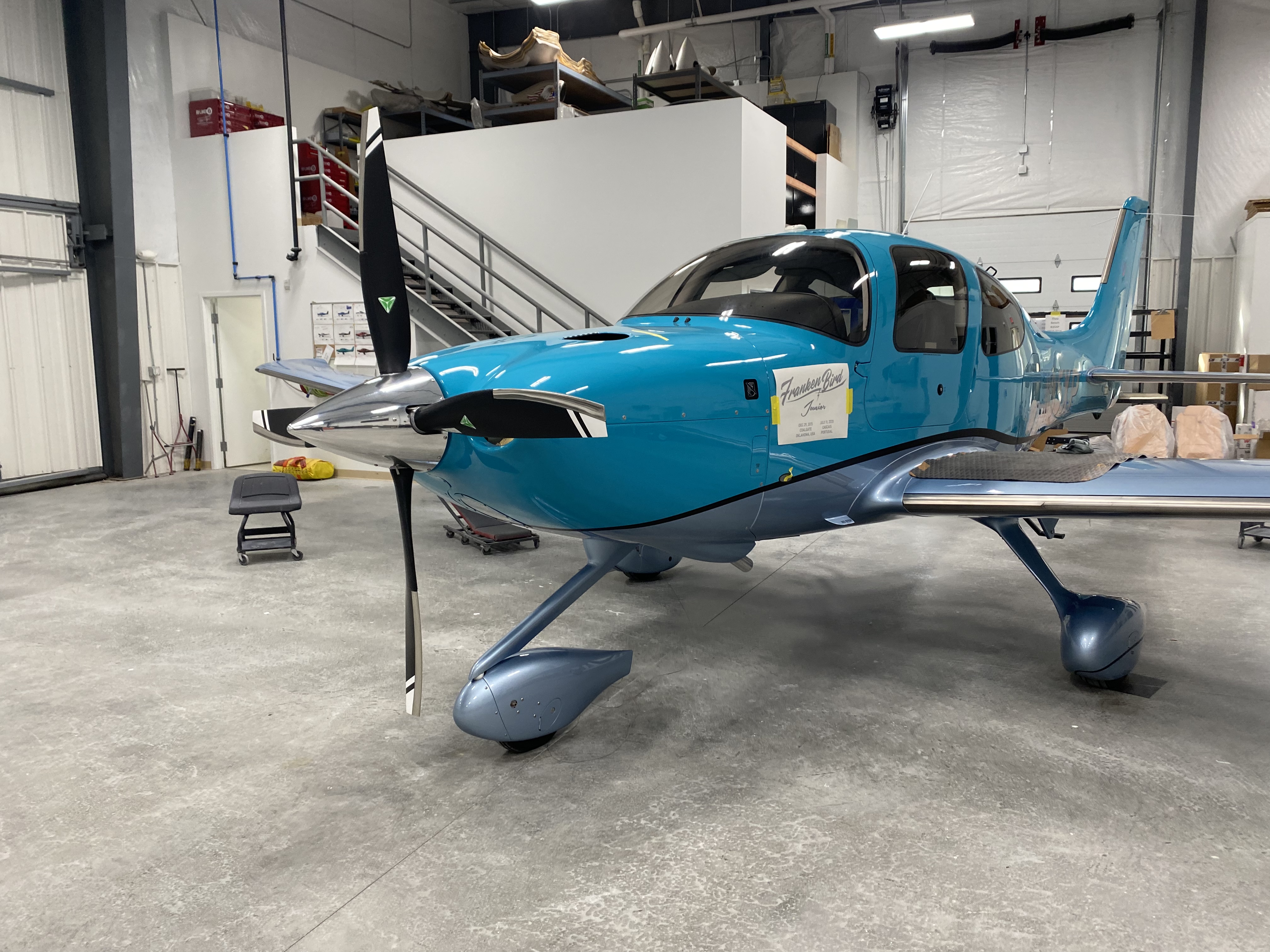

Polished has been out of style for a few years in my paint shop.
We put this new polished spinner on this plane yesterday and we all thought it looked silly.
Sent the owner a pic and he said paint it.
I’ve polished a lot of aluminum and it is not what I call fun.

Ross4289 wrote:Polished has been out of style for a few years in my paint shop.
That's a painted composite MT spinner, right?
No, that’s a brand new MT polished aluminum spinner on a brand new MT prop. It’s now flat black at this point.
