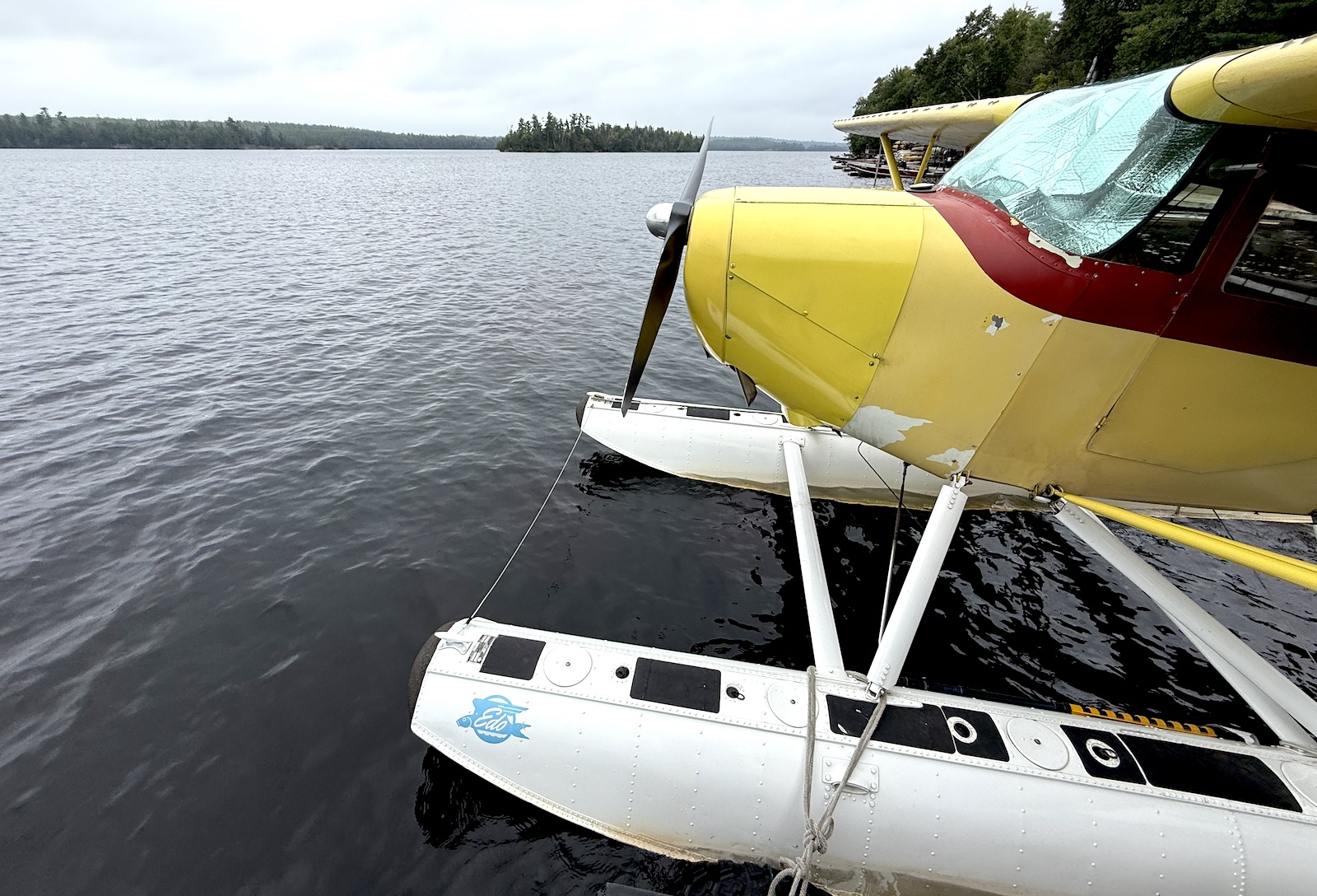

Looking for user experience in climb/seaplane prop for an 0-200 installation.
