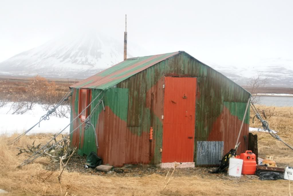

This is a cabin down on the Alaskan Peninsula that we stay in. Years ago, it has been moved by strong winds more then 10 yards. So now it's tied down. At this location, we did use old tires dug down 4 feet and buried in the ground. Winds can get close to 100 in winter. We've seen 50 mph here while we were tied down.
