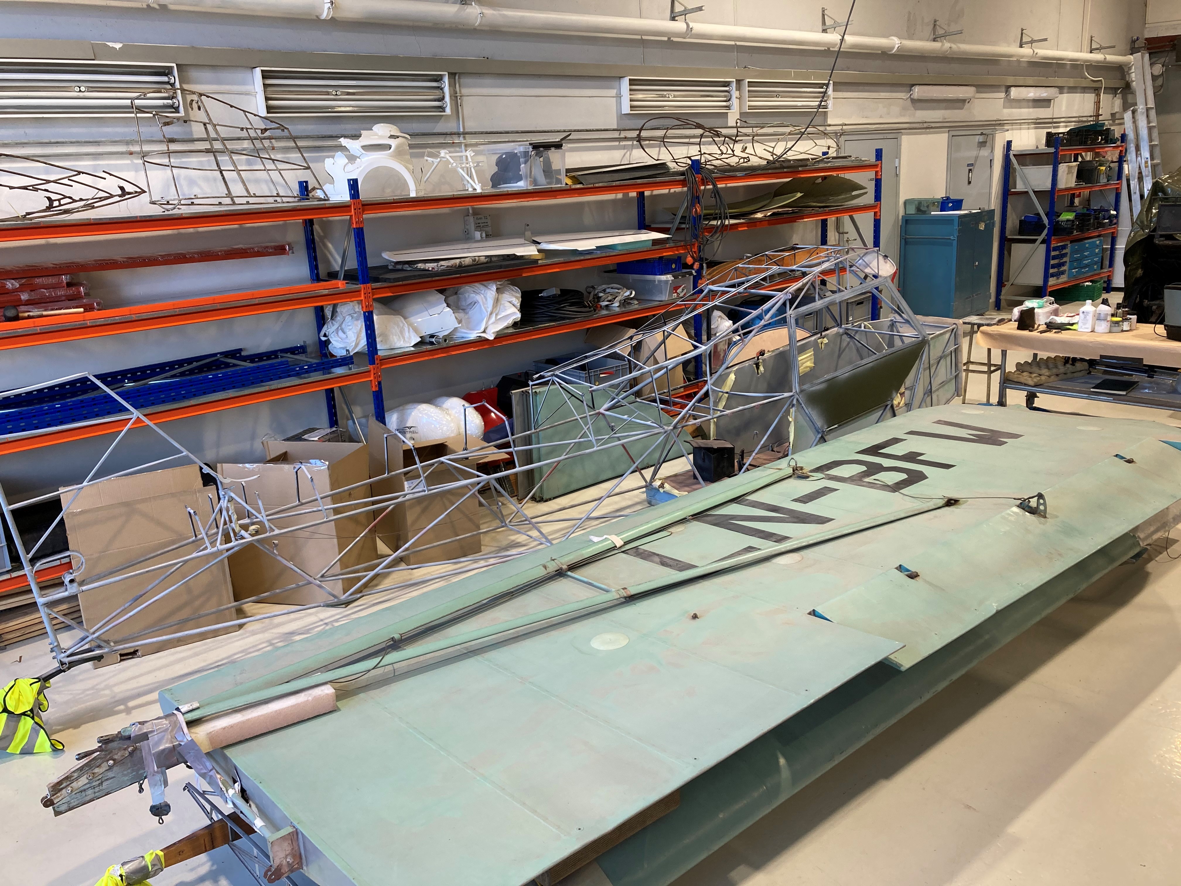

I work as head of collections at the national norwegian aviation Museum in Bodø. A while back, I came across an old cub sitting in a barn. After a bit of research, I found out that this bird was built as an L-4 in 1944, and that it was shipped to Normandy where it where it flew until the end of the war. Norwegian aviation after the war was in shambles, and the Norwegian Aero Club decided to buy a bunch of old L-4 from the US Army, turn them into J-3s and distribute them among clubs all over the country. This was "civilized" and flew at many different clubs all over Norway until 1982, when it had an accident. The club sold it to a guy that intended to fix it and fly it again. Life got in the way, and it sat in a barn until last year! After many inspections by a bunch of people who knows a lot more than I do, I was talked into buying it for the museum, with the intention to restore it an fly it!
Here is the bit that might piss off some of you: it will aboslutely NOT be restored to it's 1944 L-4 standard, but it's last well known condition as a club plane. There used to be many of these "NAK Cubs", but every. single. one. who has survived has been turned into WWII Grasshoppers again. So an important bit of norwegian flying aviation history is missing. A huge number of people learned to fly in these things, and they were the backbone of civilian aviation into well into the 70s.
So watch this space! I suppose a build thread might be coming up as we get into it.
A little heads up though. I am an academic and my responsibility is administrative as head of a department. So I don't know much about the practical work. Luckily we've teamed up with some very skilled people to do the actual work! They're restoring and flying warbirds, so they know what they'll be doing.
Myself, I'm a sport pilot, but when we begun this project, I immedietaly began PPL training. Until now I've thought that the plane that would fit my mission the best would be the ICP Savannah. But looking at the Cub, I'm beginning to have second thoughts... How about a "restomod" J-3/PA-11? Let's say the starting point is a Wag Aero Sport trainer. What would you do to it to make it the best possible classic/modern Cub? I'm thinking Wing tanks, PA-11 windshield, Oratex, add left side door, copy the aileron mechanism for flaps, maybe consider more modern engines (D-Motor LF-26, Rotax, Aeromomentum, ULPower etc), and maybe somewhat improved ergonomics? What would YOU do? A full on bush plane doesn't make much sense in Norway. Landing anywhere outside an airstrip, a private field or in the ocean is not legal.

I get the feeling some of you didn’t read my post well enough or matbe inwrote it badle. The original L-4/J-3 will NOT be modified in any way!
The idea I’m toying with is to begin with a brand new Wag Aero Sport Trainer, and modify it to be a classic plane with some of the functionality and features of a modern plane
The one on the picture will be faithfully restored to last well-known. Neither warbird or restomod :)

As I said, the real L-4/J-3 will not be modified in any way. I am trying to convince the restoration team to go for cotton, but they're a bit hesitant since it's a flyer...
When people ask about modding a real J-3 I totally get why it should be kept stock. For what it is, it's a brilliant little plane. But if a Wag Aero is the starting point, and the idea is to make classic/modern hybrid that get's the most out of the original J-3 design, then what could be done? It depends on what characteristics you'd want to keep. Having no flaps might definetely be one of those. But if functionality comes first, wouldn't a set of flaps be of any use you think? For the sake of simplicity, I thought just getting an extra set of ailerons and fit them on the inside of the actual ailerons on the wing. And why add a left door? Symmetrical bubble doors!
Yeah I know, it's just as good to just get a plane that already has most of these features. A Rans S-7 is quite close... It was just a brain fart that didn't take rationality into consideration at all :P It's going to be fun joining the restoration team working on the real Grasshopper/Cub, and then fly it. Maybe the pure experience is good enough to promp an as-true-as-possible Wag Aero build...
What are the experimental rules there? Can you fly a plane there with no electrical system? No radio?
Don't have to have an electrical system, but you need radio and transponder. We're looking at sticking them in the wong root.
