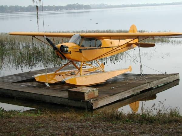

Here is a picture of the ramp our flying club uses for the Cub. It is made out of used light poles and rough sawn lumber, very inexpensive and gets the job done.

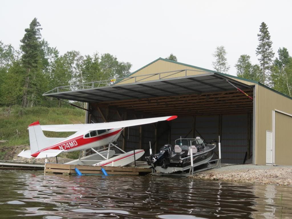

This is a shot of the rail system I use to get my plane in the hangar, it is very similar to what Aqua is using. A little more costly to put one of these in, less hassle than a ramp, but requires electricity to power the motor. It all depends on your wants and needs.

Now that's one heck of a nice setup with that hangar!

Unless there is a big ramp available to taxi onto (think a true seaplane base, or paved public boat launch), it seems to me that operators would be better off handling their amphibs as straight float machines.
So if you want to keep it simple; I'd go with something like Steve's flying club ramp, with the gear up. (You'd need a shallower angle with those long floats) A dock alongside would make it a lot easier.
BTW, the boat in Steve's hangar is sitting on what looks like the exact model beacher we converted.
