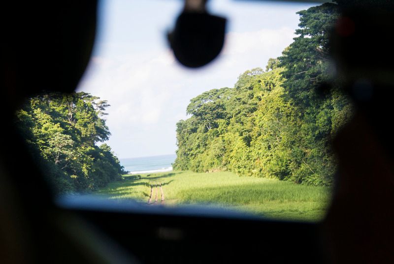

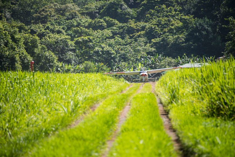

Ruts are getting too deep at this strip.
Any tips on how to fix it?
They put gravel but with rain and use it just goes away.(Even it doesn get hardly any use)
Place is remote , no acces by car, just 3 hr boat ride, 6 hrs hike or plane, so not many tools to fix it.

You did a good job concentrating on the target touchdown spot. The high trees make the closure rate appear too fast so you have to ignore them.
The only thing you can do is put a grader on a barge and crown the middle and ditch the sides.
Re: Rutted , narrow ,short jungle strip !
Its easier to fly down and put the plane over the roots from the tree side than landing fron the beach and trying to hit the ruts when on the damp gras and sideways.

The only way to beat flatness is by digging a valley and making a hill. In mountain flying, we have to pay attention to which way God has drained the mountains. In dirt work, we have to make the drainage. We have to start at the low point, even if only six inches, and work back toward the higher. We steal dirt from the drainage to make the mound all the way back toward the six inch higher ground. It's tricky. You need an irrigation level.
If the ocean is six feet lower, at high tide, you have enough grade to put in a fine golf course.
We in the US always think machinery. It is amazing what is done with human labor when that's all there is. Even better if there's LOTS of it.
The strip looks wide enough that it might be possible to cut the high stuff and move over as Terry alluded to. As far as fixing the ruts, it sounds like some work has been done with gravel so the indication is there are means to do some work. Geotextile fabric is pretty magic stuff when applied over a soft subgrade if you have something fairly competent to cover it with. Probably couldn't get a 15' roll of it in your airplane but you could cut it into manageable pieces you could fold like a tarp and haul in.
