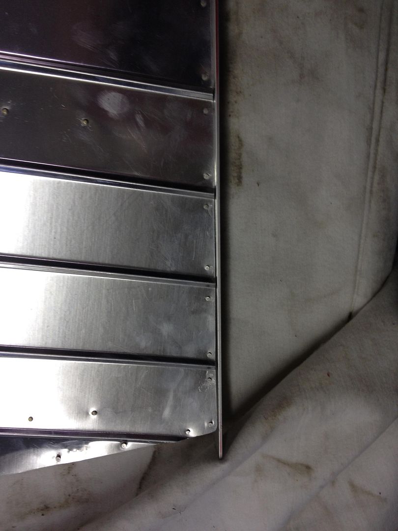

well it is slowly coming together. All parts for the engine are back and at the IA's shop, new carb, mags etc. The prop is in the hangar waiting for the IA to get the engine built and hung back on the plane. I took the elevator and stab to a guy 75 miles away who has been doing sheet metal repair work for 50+ years and came highly recommended..... He called and said the shit was ready to pick up so I drove down there and this is what I got for $3650.00...
big gap on the stabilizer skin overlap
Clamp / plier marks all along the edge of the elevator
crack in the skin on the bottom of the elevator
top side of stab had a bubble in the skin and the rivet was pounded in so hard that when you put a straight edge over the skin the rivet head is almost 3/16" below the surface of the skin.
The stab skins dont even come close to matching the fiberglass tips
99% of the rivet heads were pounded down below the surface of the skins.
When I confronted the guy, he said all he would do was "repair" the crack in the elevator and put a 185 leading edge skin on the stab to hide the shitty work and big gaps. But as far as the rest of the rivets being pounded too hard, I was just being "to nitpicky" I don't think it is too much to ask that new skins not look like they have been through a hail storm. The bad part is he has these tagged as serviceable... anyone else see anything wrong here?

Wow.... I wouldn't be very happy at all right now and I'm sure you're not.
Re: Saving a ramp mummy: Cessna 180
not happy at all right now.... Thinking about taking the parts to the FSDO and seeing what they think of a certified repair station putting out this kind of work.
If the guy would make it right, and reskin it right I would be happy, but telling me that I am being too picky pissed me off. I dont have a photo of it, but if you put a straight edge on the trailing edge of the elevator, its 2" off.

The trailing edge of the elevator. I can't find a straight line on the elevator or the stab. If you draw a string line across the leading edge of the stabilizer, the tips on each side go up about 3/8" I don't figure I need any dihedral in the stab...

man that really stinks, i would be pretty angry too. I don't think you are nit picking here...

Wow. Thats brutal! I think I'd definitely be showing his "certified" work to the FSDO if he doesn't fix it properly...

That's just not right! Those sunk rivets are not airworthy. The structure underneath is deformed most likely. I think I would tell him to buy you new skins and you'll go somewhere else to have the work done.- Otherwise, the FISDO will get to have a look and you will see him in small claims court. I wouldn't put that on one of my aircraft. My 2 cents [-(

I think when I get home I will load the parts up and take the 150 mile drive to the FSDO.. The more I think about it the madder I get. If he dont want to make it right, then its going straight to the FSDO.

None of my business, but if that's the quality of work he does when being payed, what kind of quality would you expect when he'll be doing it on his time. I would find someone else to do it properly and ask for my money back. Other wise let the FSDO and the court sort it out.
