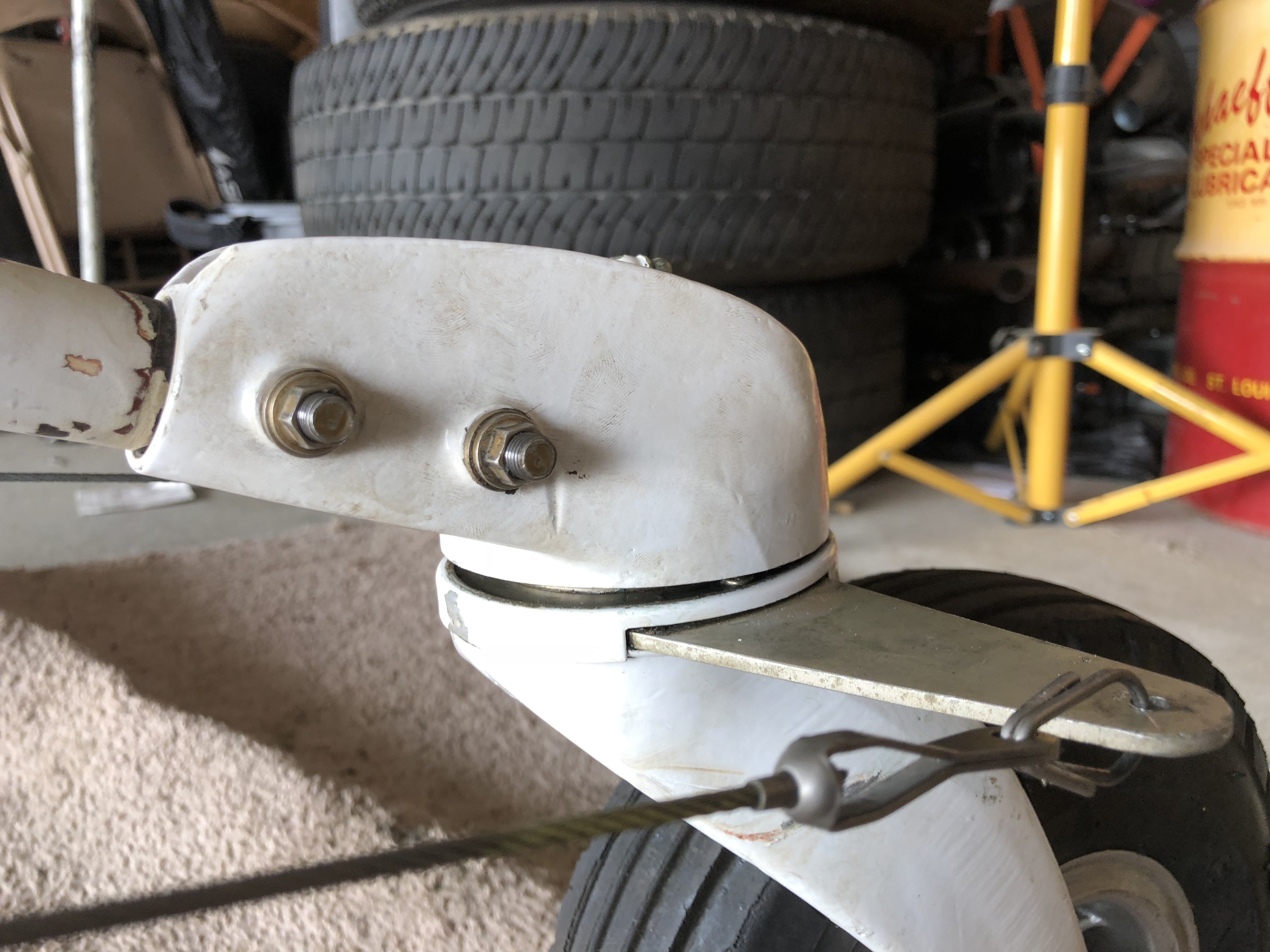

I replaced my baby bushwheel with a 10” Scott 3400. After I set it down it looks like the arm is cocked in the mount. The through bolt is as tight as it can get, it feels like the nut is hitting the shank of the bolt. The BBW has to much grease around the pivot faces for me to tell if it sat the same way, but I’m wondering if I need a shim or something for it.
Thanks
Rod

It certainly looks like your center pin/bolt is loose, you show a visibly larger gap in the front than in the back.

I think that there is a ring that appears to not be installed between the two halfs, where the assembly joins together. There is an exploded view in the aircraft spruce catalog. I don't have one here right now though.

Thanks to Hotrod180 I figured out that part #16 had a small burr on it and it was not letting things go completely together. I cleaned up the burr and it went together like I expected it to.
