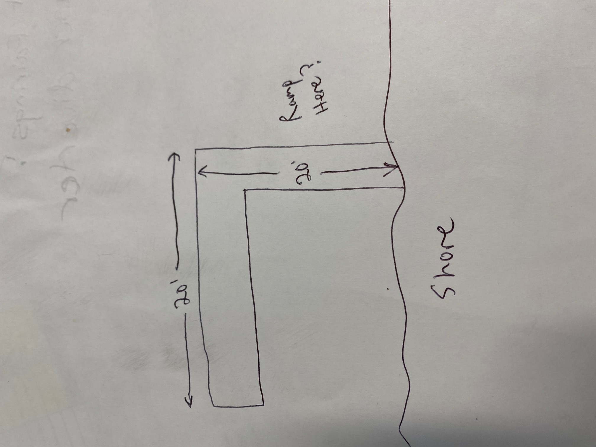

Attached is a drawing of where I'm thinking of putting the ramp.

Congratulations on your new airplane!
I agree 100 percent with MTV. Wood ramps work great! They are all over Anchorage on Lake Hood, Campbell Lake and others. Dont put it too close to your dock, when coming into the ramp with the wind blowing the last thing you want is potential objects to hit. Also, you dont want the wing over hanging the dock, people will hit their head on the wing while walking on the dock.
Re: Seaplane ramp help
Thanks Kurt! Can you or anyone else help with a quick sketch on how to build? I’m thinking 20’ 4x4’s as stringers, and 12’ 4x4 “ribs” on top of that, with 20’ 2x6’s as decking (parallel the direction of the aircraft).

If it's 10' at the end I wouldn't put it on bottom, 12-18" should be good, keep the slope as shallow as you can.
also I would have the 2x6's perpendicular to the floats (parallel to the shore) that way the floats will sit on the keel, I wouldn't want to chance the keel getting caught in the seams, at least that's the way I built mine.
Here is a video of my ramp, this was my first try at it and it is way too steep, I dug it out and reset it. I have a steel frame buried in the ground and a steel frame under the portion in the water. it is pinned together so it can pivot and I lift it out of the water in the fall. I don't get a lot of ice movement but the 2 years I did leave it in the water took the 2x6 that was at water level with it in the spring.

Build a frame out of 2x8’s or 2x10’s so the boards are vertical and run parallel to the floats, space the the boards about 2 or 3 feet. Next cover the top with 2x6’s perpendicular to the floats leaving a gap between them of about half to 3/4 of an inch. Make sure you make the ramp plenty wide keeping in mind that a perfectly centered ramping may not be possible in the wind. Give yourself some room. Figure out a way to anchor both ends. We never removed ours in the winter, nor have I seen any removed, everyone left them in, the ice no had effect on the properly anchored ramps.
I caution you, over time the ramp will get real slick, easy to fall and bust your backside! Also, make sure no screw or nail heads are exposed, you don’t want them scraping the keels of your floats. I suggest screwing the whole thing together, use countersunk screws.
