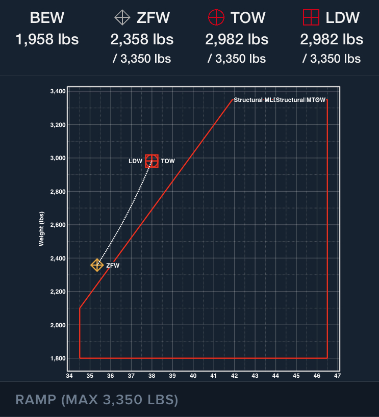

Another issue Hot Rod, is that even though everything you add to the back is behind the cg, it doesn’t mean it won’t be too far forward. The graph has an angle on the upper portion of weights, so if you just add two heavy people and gas, you will move too far vertically on the WB graph and out of the envelope. On the picture below, the orange dot is with 2 x 200lb people. The next dot is with full fuel. I’m wayyyyy out there. My cg is 34.8 empty. So it’s not that crazy far forward and I imagine lots of people with modified wagons, especially 182s, are pretty similar.

You're right.
My airplane is 1652 empty at 34.6" CG.
Two pilots at 170# each & 40 gallons fuel adds up to 2232# & 36.2" CG--
just barely within (or maybe just forward of) the envelope.
Except my usual 20# or so of stuff in the extended baggage at 124"
makes it 2252# & 37.0" CG....in the envelope.
And plenty of room farther aft in the envelope to carry my anvil collection in back.
I don't recall if you said you have a firewall battery or not.
If you do, your easiest CG solution would be to relocate it to the back again.
Otherwise, just carry a big survival kit in back, as others have suggested.

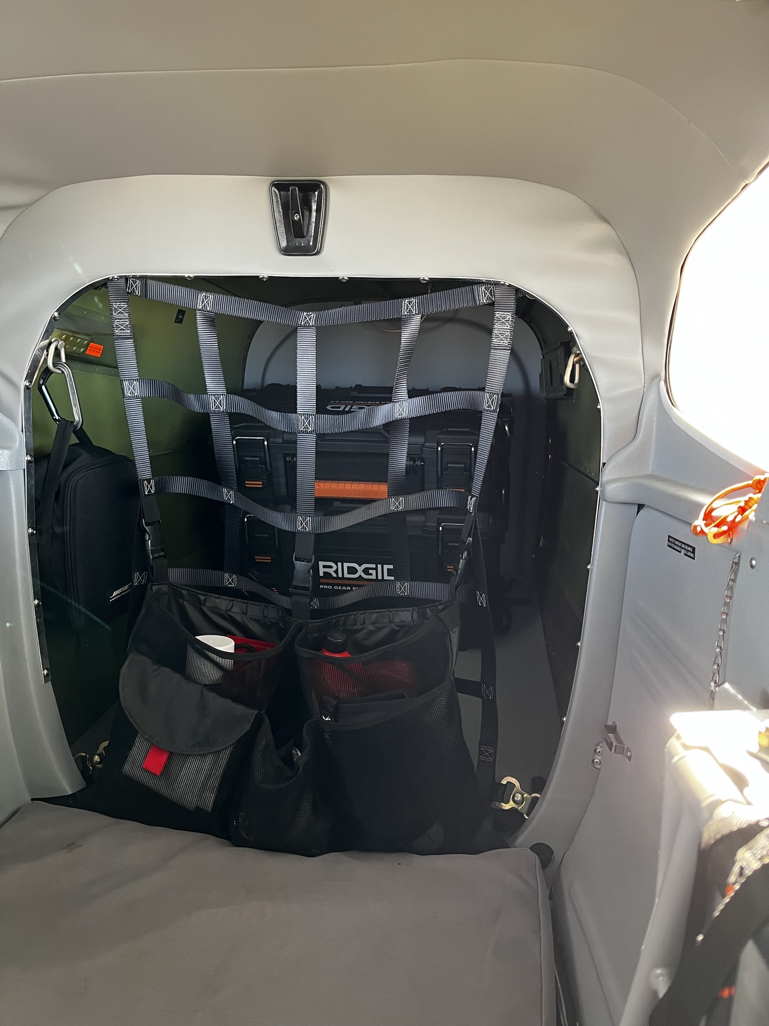

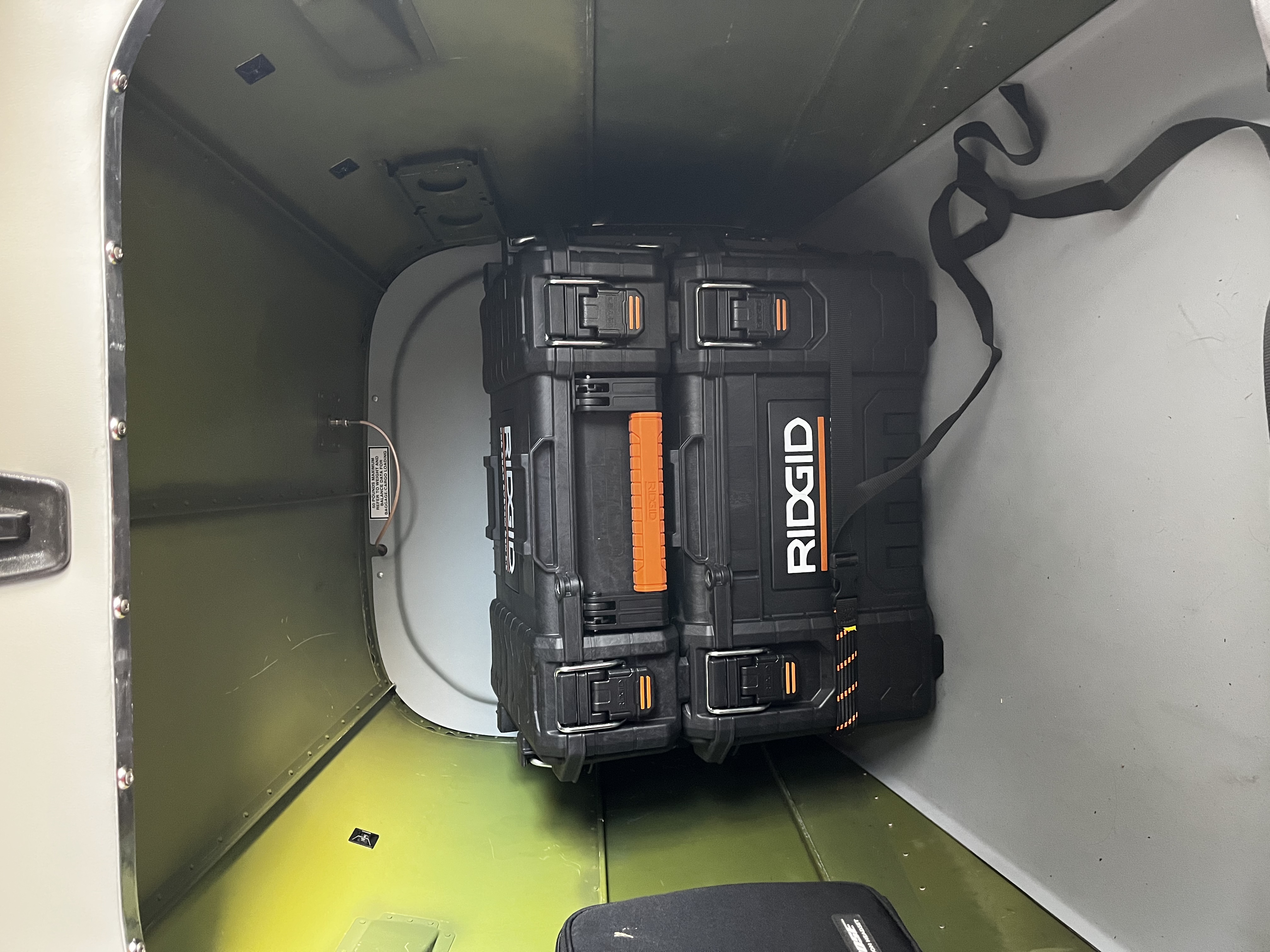

Yup I do. Firewall battery moved it 2” forward. Pretty big move.. My new ballast includes all the goodies and weighs 50 lbs, tent, rations, backcountry tie downs, alight air compressor, tools, everything one would need. Moves cg 2.4”. It might be a little overkill but it’s all really nice to have. I could stack them and keep it 10” behind the center of extended baggage. I like it but wondering if the hard cases are maybe a bad idea. At least they are tied down well.
