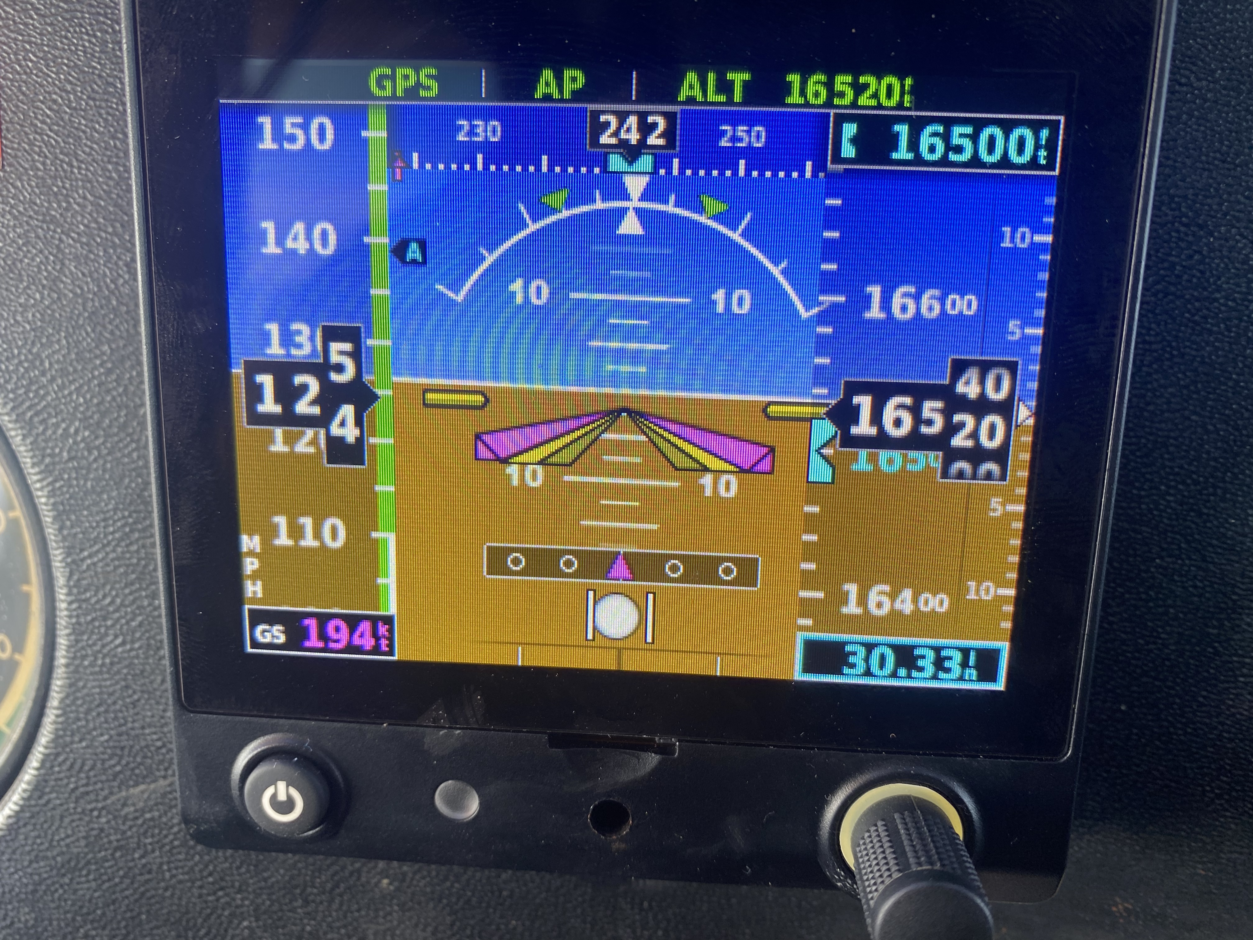

My 185 with a 550 and Mac 401 prop was still climbing at 400 fpm as I leveled off at 16,500 on an about standard day.

Ross4289 wrote:My 185 with a 550 and Mac 401 prop was still climbing at 400 fpm as I leveled off at 16,500 on an about standard day.
Just curious, does the G5 redline drop at that altitude?
Posts: 1679
Re: Skwyagon Service Ceiling
I don’t think a variable VNE is possible on a G5.
On a turbo Cirrus with a G5/GFC500 and a variable VNE, they just pick the lower one for the G5. It’s highly annoying since you can bust 160 KIAS in level flight at lower altitudes, and the autopilot pitches up.
